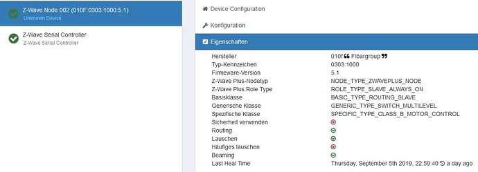

Hello everyone, I need help please for the same Problem.
My Hardware:
#1Raspberry Pi 3 Modell B+ with openhabian-pi-raspbian-201908050414-gitca0976f-crc6a66b5a1.img.xz
#2ZMEEUZB1 (Z-WAVE Controller)
#3Fibaro Roller Shutter 3 (FGR223)
My problem is that the RollerShutter stands there as an unknown device. I read everywhere that you can expand the database on cd-jackson.com. And the device is also listed there
EDIT: OK, I’ve overlooked it. It’s openhabian-pi-raspbian-201908050414-gitca0976f-crc6a66b5a1.img.xz
It’s the latest version. I don’t know if device is in there… Sorry.

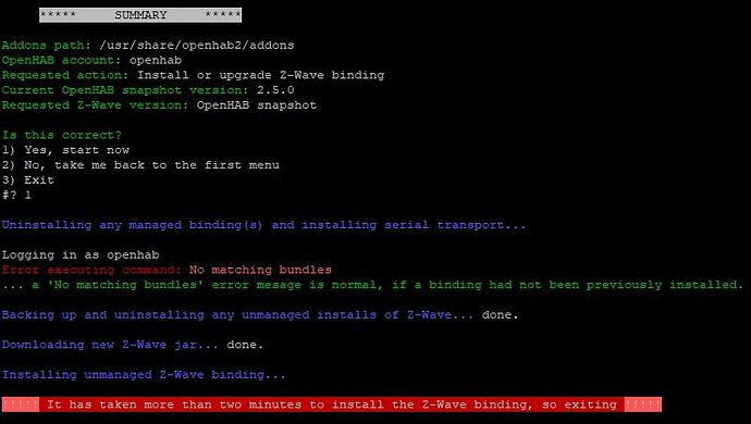

I had the similar problem last week with the fibaro rgbw module. It was not recognized…only as fibaro. On openHABian I pulled the latest release 2.4 and the database of z-wave got updated too…try to pull latest update (with openhabian-config) maybe this helps. And of course exclude and include again

The log shows that the binding is not searching for your device. It looks like it doesn’t contain any new devices for the past few months, which indicates that maybe you’re running an older binding than you think?
I would suggest to check the versions using the console - ie logon to the console and list the running bindings to get their version.
You are using quite an old version of the binding and it doesn’t contain this device. The version you have is 2.4 which was released in December last year if I remember correctly.
You will need to use one of the newer 2.5 versions - 2.5M2 should be ok I think.
