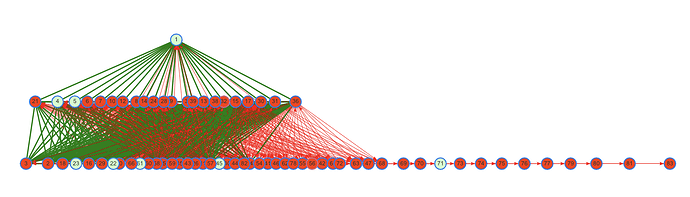

I’ve updated to the 2.5.1 snapshot linked in another thread and heal is still destroying my network causing me to have to restart my openHABIAN pi to bring all the nodes back online. You can see that my network needs to update the neighbors because the last 20 or so devices I’ve added haven’t correctly mapped their network. Heal doesn’t seem to be working on individual nodes, either.
Firstly that map does not necessarily reflect your network’s routing. It is a list of neighbours reported during a neighbour update. I ignore it as it looks nice but is not massively useful. Zwave routing is a bit more complex.

That mao is on a different tab and you need to press the reload button. This button calls the API and the controller passes the current topology to the PC Controller Program. On first visit it will be blank.
