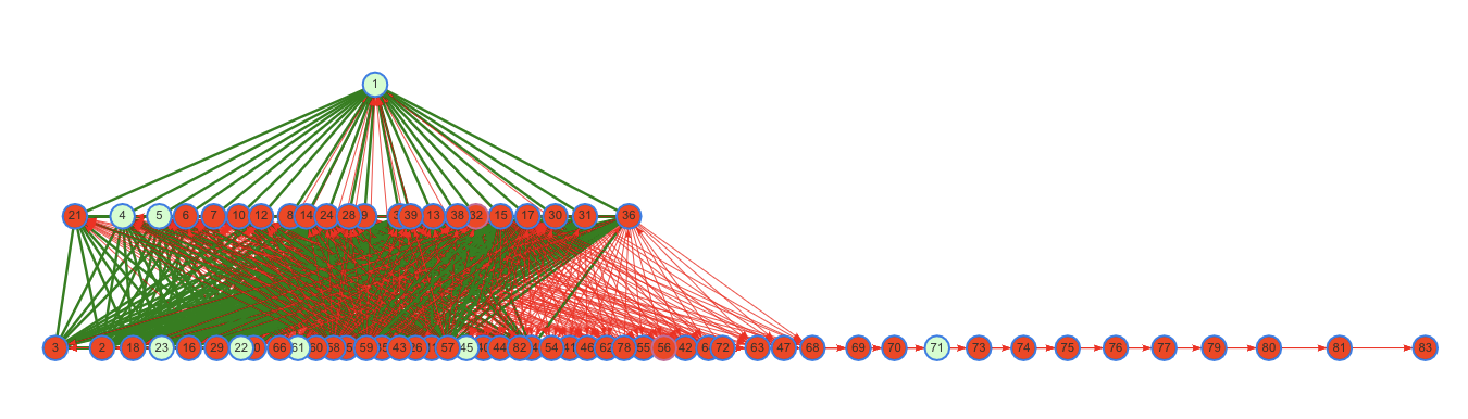

This is not relevant to any routing. It is simply a report of neighbours discovered by a heal. It is in many ways a confusing thing. The actual route used could not be listed on here and it would be no issues.

That diagram is of no help in understanding the routing in use in your network whatsoever. It is a picture of a historic moment in time of what nodes had what neighbours under very abnormal conditions. i.e. when using -6db signal to communicate. For this reason it will never show you the full potential of routing nor the route and if heal is not working is never updated. Even if you heal using PC Controller program it will remain broken but your network routing table held in your controller will be fine.
To see the actual routing table follow my instructions here
This is the view read from the controller in PC Controller Program. Even thi sis limited as it gives no information on the quality of communication.
