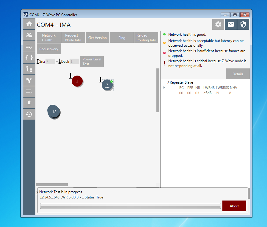

To see the actual routing table follow my instructions here
This is the view read from the controller in PC Controller Program. Even thi sis limited as it gives no information on the quality of communication.
If you want that then a network health check would be worth running

I strongly suggest if you have time to put your controller in PC Controller program and look at the actual routing table and run a network health check from that program.
This actually sends commands to your device and tells you if you have anything to worry about.
