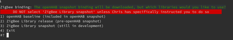

Run the script again using option 2 when selecting the zigbee libraries. TMK, Chris has not instructed you to use the snapshot version of the libraries, which are actually coming up with an older version 1.2.9) than the pre-openHAB release version (1.3.0).
Running the script again should resolve things, but if not, what is returned when you execute this in the console…
