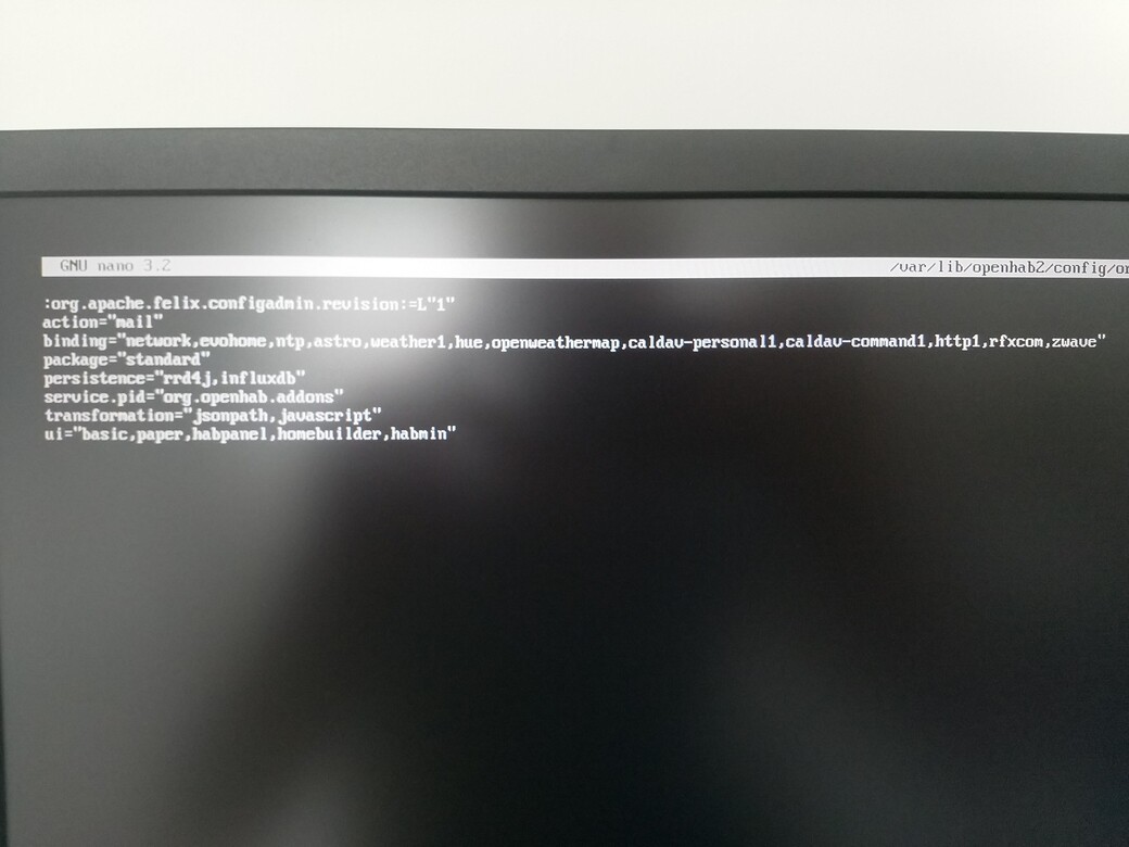

Thanks for this reply. I Have found both addons.config but do not know what to do now?
My config looks like this. There is no restdocs. Im actualy on opanhabian (Raspberry pi 3)
Your openhab.log should be telling you something about that.
Could this be the reason:
2020-07-05 14:23:29.170 [ERROR] [core.karaf.internal.FeatureInstaller] - Failed installing ‘openhab-action-mail’
I believe there were some changes regarding mail.
@Lugor → Thank you! You saved my day :slight_smile:
I was always looking for the wrong addons.cfg file.
