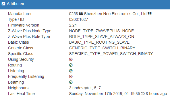

This is what I see in habmin

It might help if you provide information on what your problem actually is? You’ve just stated that teh inclusion process doesn’t properly finish - what happens, or what doesn’t happen. What version of OH are you using? How are you configuring your system?
The “complete log” is not very useful since it does not contain any information during the inclusion process which is where you say the problem is?
What is the real problem? If there is a thing, then it should have channels - if you can’t link items to the thing, then probably the issue is not with the inclusion of the device.
In order to help you, we do need to have some information on your problem…
