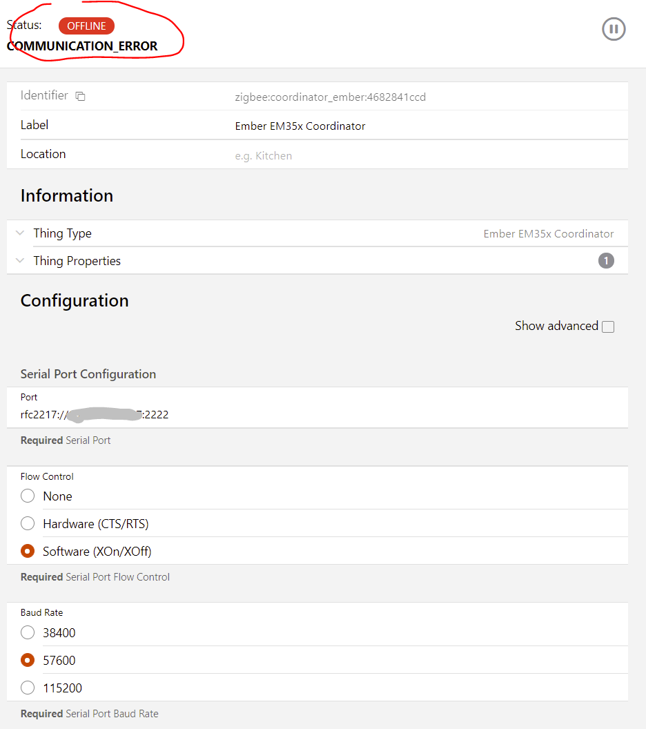

Unfortunately, the Zigbee coordinator thing remains offline:
The tcp connection to the remote Pi with the Zigbee stick connected got established but it seems, that openHAB cannot “open” that remote serial port yet…
Has anybody yet a working setup with rfc2217-connected Zigbee coordinator? Preferably Ember based? If so, would you share your ser2net.yaml and openHAB thing configuration for it?

AFAICT, the combination RFC 2217/openHAB Zigbee Binding 3.2.0 snapshot/Ember Coordinator does not work - for a detailed low level discussion see:
Workaround: use socat instead of RFC 2217, see step 12:
