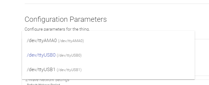

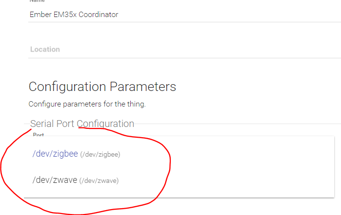

Well, might be the case. My Debian shows perfectly all (socat-provided) serial ports.
When I click on the port configuration, it opens the list and let me choose from the existing entries. No add possible… :frowning:
Both:
For completeness, my PaperUI
