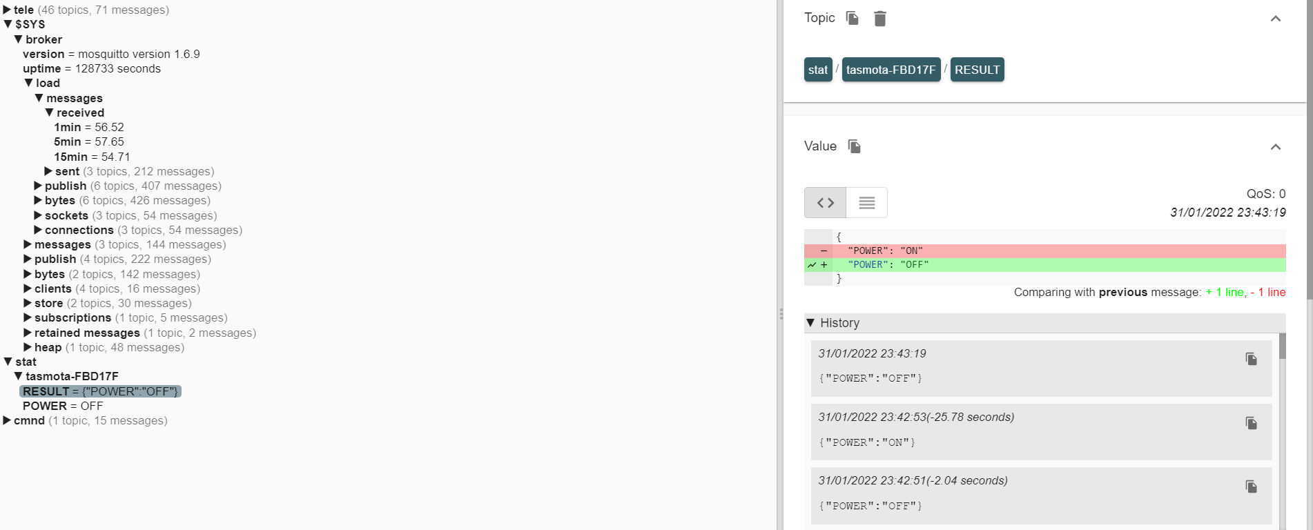

Next step is to work out when the message reaches your MQTT Broker - use MQTT Explorer or MQTT.fx to monitor your broker.
Thanks @hafniumzinc anything specific to look for in mqtt explorer?
I noticed below in the particular topic. Also noticed that the lag does not happen every single time - when turning it on/off repeatedly. the lag happens approximately 1 out of 8 times.
cmnd
tasmota-FBD17F
POWER = ON  ----> this turns on immediately
stat
tasmota-FBD17F
RESULT = {"POWER":"ON"} ----> this remains off and turns on when the light turns on after 4-5 seconds
POWER = ON
So you’re saying that data into the MQTT broker on the cmnd topic is almost instantaneous, but data on the RESULT topic is much slower?
The cmnd topic comes from openHAB, so if the above is true then openHAB seems to be running fine.
The stat/.../RESULT topic comes from Tasmota, so if the above is true then there seems to be an issue within Tasmota itself.
Next thing to check: go to the Tasmota console and watch that as you switch the light on and off with openHAB.
That’s right for both the statements.
