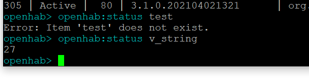

- karaf console (new to me, checked it because you mentioned “logger”): openhab:status itemname

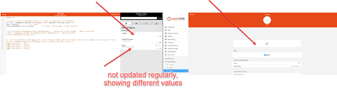

- trying the code doesn’t update v_string regularly (it sometimes does, right now it doesn’t, even after reboot; tried several versions, now as //comment)

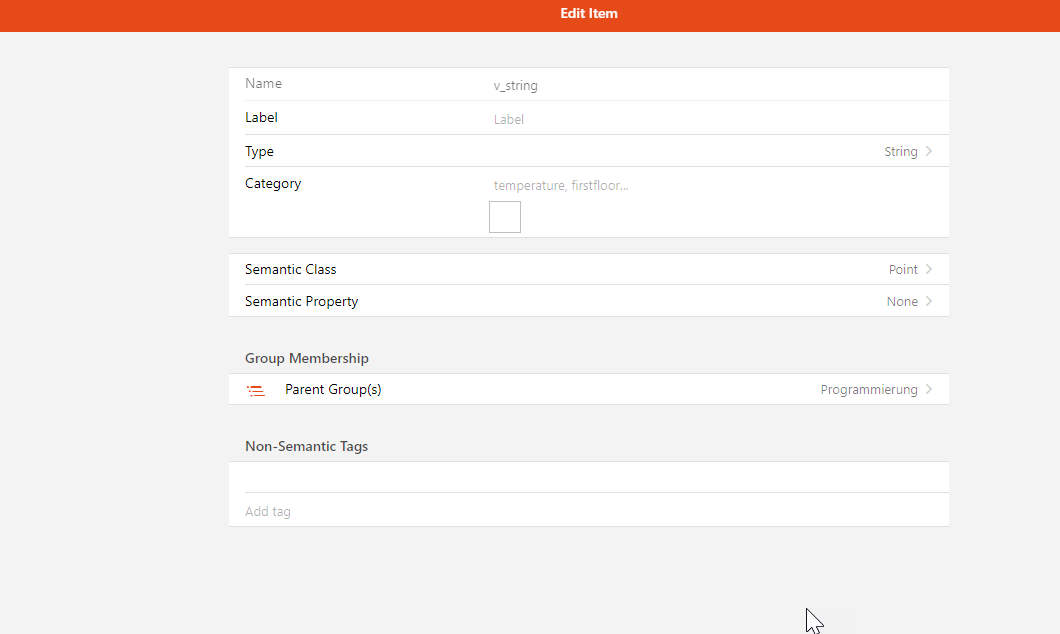

Here the definition of v_string:

And two last screenshots showing different values:
