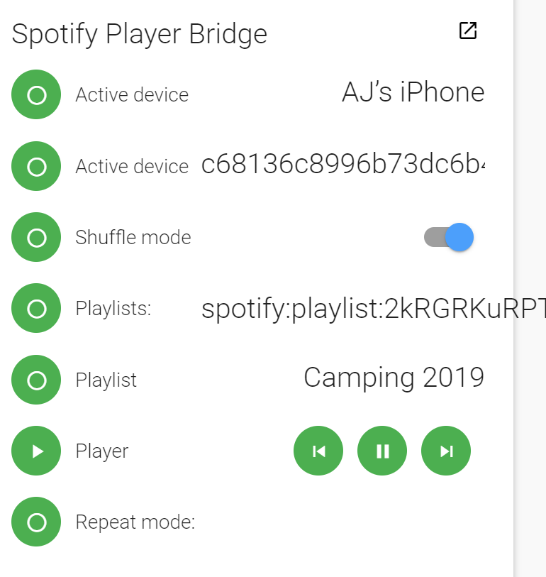

Hi Hilbrand, congrats and thank you and everyone who has contributed to this great binding.

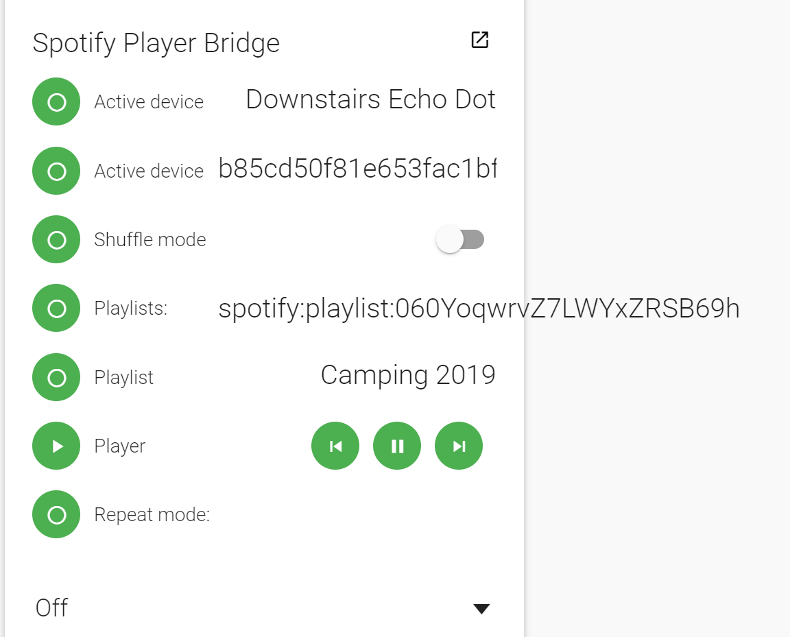

In PaperUI Control and BasicUI everything is working perfectly only in the IOS app I am having trouble with the Active Devices and Playlists selection field. If I push on e.g. Active Devices the selection window opens but there is nothing in it so I cannot select e.g. a different speaker. Also the current selected device and playlist is not shown. I assume that everything is correctly configured since it is working in the BasicUI but maybe I am missing something. Has someone experienced the same problem and has a “fast” fix for that problem?
I have this in BasicUi as well - at one point everything stopped updating and a binding remove was my only option
I must be completely missing something here as I can’t get anything to appear in either the Active device or Playlists selections…
Regardless of browser I use, chrome or safari, in Basic UI the screen just goes a kind of shadowy grey without a list appearing.
Any clues?
@lampml16 @Andrew_Pawelski @Mark_Webster Make sure you have the latest version of the binding installed. The latest version uses device name as identifier. If you had an earlier beta version that used id as identifier you need to remove and re-add the things. An older beta version of the binding had lockup problems causing it to not give updates. If you had such problems you need after you’ve updated the binding restart openHAB to clear any locked threads. The correct version can be seen in the title of the binding when installed. See the first post in this thread for up-to-date information on what version is the correct version.

Tested the sitemap, still cannot see a list of devices or playlists (Screen still just goes a kind of grey in both Chrome and Safari)
I would guess it’s either the configuration or the lists are not populated. The configuration in the sitemap should be something like:
Selection item=spotifyDevices label="Active device [%s]"
To see if the lists are populated at all you could set the log level to trace in the karaf console ( log:set TRACE org.openhab.binding.spotify , and back when done: log:set DEFAULT org.openhab.binding.spotify ). Maybe it gives more information.
–Edit: the example configuration contained a typo.
I was not usning the beta binding, so have done the same as @Mark_Webster and get the same results - all works but the Selection items which gives me a full screen “greyed out” overlay with nothing in it for playlists and devices - the single versions of these work great - I will up the logging and see if I get anything
