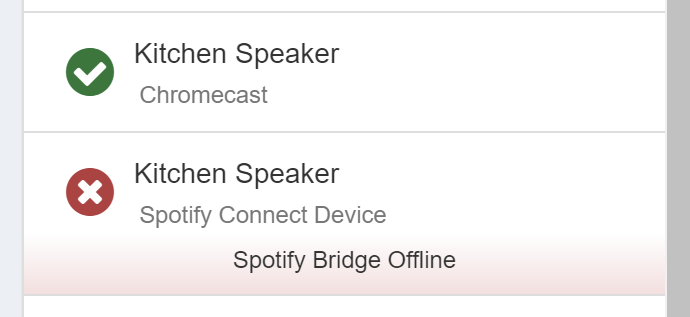

I should add that I can only switch the output to a device thats shows up on this list:
curl -X "GET" "https://api.spotify.com/v1/me/player/devices"
The Chromecast binding seems to think the device is active, but Spotify binding does not.
How can I wake it up the way my Spotify app does on the phone?
