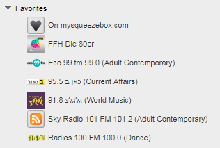

I’m getting a bit weary of manually updating my playlists in HABpanel every time I add, change, or delete one on the LMS.
So, I’ve been thinking of extending the squeezebox binding to pull the list of Favorites from the Squeezebox Server. That way I’ll never need to update HABpanel when I change a playlist.
I already have a very basic prototype running on my test box.
Here’s what I’m considering:
  • add a new String channel to the SqueezeBoxServer thing called favoritesList
  • the list will be updated periodically (like every minute) with the most current favorites from the LMS
  • items linked to favoritesList will be populated with a comma-separated list of favoriteId=favoriteName
  • add a new String channel to the SqueezeBoxPlayer thing called favoritesPlay
  • items linked to favoritesPlay will cause a favorite to play when sent a command with a favoriteId
Favorites can reflect local music playlists, stations from streaming services like Pandora, Slacker, and Spotify, and streaming radio stations.

So, I have this working.
  • the SqueezeBox Server favorites channel (favoritesList) is updated immediately when the binding starts, and when the favorites list is updated on the LMS (lucky for me there’s a notification from the LMS when the favs are updated).
  • the channel is formatted with comma-separated values, like this:
1=Rock,2=Folk,3=Classic Alternative
  • there’s a config option that allows you to wrap the label with double quotes
1="Rock",2="Folk",3="Classic Alternative"
  • when you send the number to the SqueezeBoxPlayer channel (playFavorite), it plays the favorite on that player. Yay!
  • Right now, it just pulls the first level of favorites (the LMS supports a hierarchy of folders and favorites). I’m inclined to leave it like this, because 1) the way the LMS API works, supporting the hierarchy adds a good bit of complexity to the implementation, and 2) I’m not aware of any UI that will consume a hierarchy like that (it would require something other than the comma-separated list of choices, probably JSON). WDYT about this?

The latest version of the PR pushes the favorites list to all players. The players then use that list to update the playFavorite channel’s state options. This means that you can use the “Server-provided item options” in the HABpanel selection widget and it will use the channel’s state options to populate the choices. :smile: The functionality to do that doesn’t exist in sitemap (yet).
