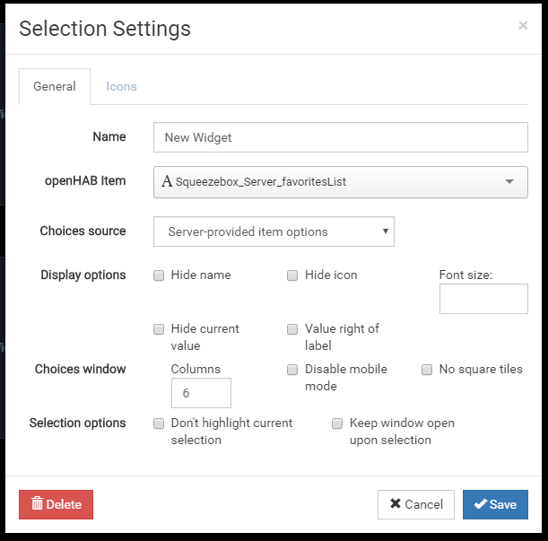

  • I created to selection widgets in HABPanel for testing: 1 for the server and 1 for the radio,
    • The server widget is showing the list as text but when I press it it says it is “No choices available - check widget config”
    • The radio widget is showing NULL.

The server Widget is still not showing a selection list but the radio widget is - Which is fine.
Thanks a lot.
Right. It’s only the item linked to the player playFavorite channel that works in the HABpanel widget.
Glad you got it working.
For the record: “server-provided item options” doesn’t mean the state of the item will be used as CSV for the options, it means some bindings provide options automatically for items linked to certain channels - like inputs for an AV receiver, you can see them in Paper UI - and if that’s the case for the item you select it will use that.

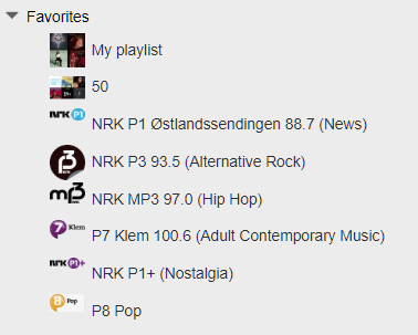

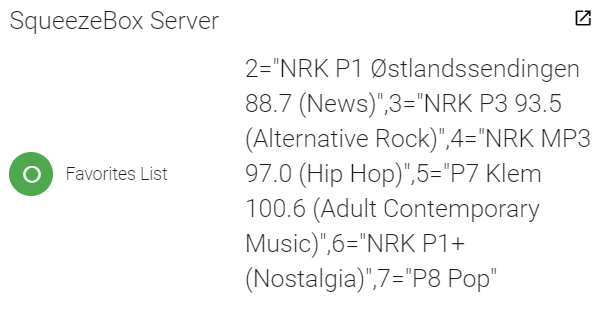

Just wanted to take the playFavorite for a spin, but Spotify (Spotty) and Tidal playlists are not listed in the server favorite list. Starting them from LMS WEB GUI works OK.
In the server list the Spotty playlist is simply ignored (not counted). Tidal is counted, but not listed.

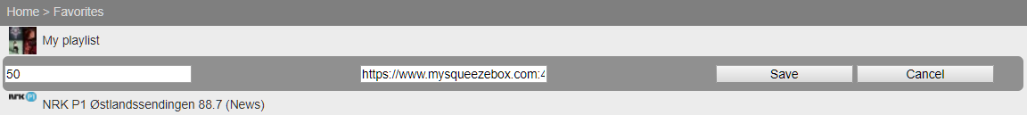

The edit for Spotty says:
Tidal:

I’ll take a look at it. IIRC, folders are the only thing it skips. By any chance, are those first two entries folders?
  1. Is a Spotify PlayList ‘My playlist’: spotify:user:olemrolemr:playlist:6NCv7jpvpaojD6L2VlNA4p
  2. Is a Tidal PlayList ‘50’: https://www.mysqueezebox.com:443/api/wimp/v1/opml/playlistTracks?title=50&id=4fd05263-65c4-4f66-b25e-06b8d3e8bb05
Are they folders? Hard to tell…
I don’t have a Spotify Premium account, so I can’t test with that.
But, I started a Tidal free trial. From what I can see, a Tidal playlist in Favorites is actually a folder that contains a bunch of tracks. That’s the reason why it’s not visible in the binding. I suspect that’ll be the same with Spotify.
I exclude folders when I pull the favorites into the binding because there’s no easy way to represent a hierarchy using channel state options.
