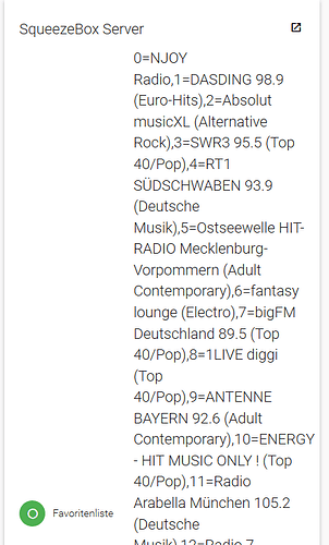

next problem for me is that the favouritesList is shown in logfile in onyl one entry and i cannot figure out how to split this:
2019-10-24 15:04:53.885 [ERROR] [el.script.Squeezebox Favoriten liste] - Squeezebox Favoriten geändert: 0=NJOY Radio,1=DASDING 98.9 (Euro-Hits),2=Absolut musicXL (Alternative Rock),3=SWR3 95.5 (Top 40/Pop),4=RT1 SÜDSCHWABEN 93.9 (Deutsche Musik),5=Ostseewelle HIT-RADIO Mecklenburg-Vorpommern (Adult Contemporary),6=fantasy lounge (Electro),7=bigFM Deutschland 89.5 (Top 40/Pop),8=1LIVE diggi (Top 40/Pop),9=ANTENNE BAYERN 92.6 (Adult Contemporary),10=ENERGY - HIT MUSIC ONLY ! (Top 40/Pop),11=Radio Arabella München 105.2 (Deutsche Musik),12=Radio 7 Ravensburg 101.8 (Top 40/Pop),13=MDR JUMP 90.4 (Adult Contemporary),14=MDR SPUTNIK 104.4 (Top 40/Pop),15=Bayern 3 98.4 (Hot AC),16=DONAU 3 FM 105.9 (Adult Contemporary),17=Virgin Radio Rock Switzerland (Schweiz),18=ANTENNE BAYERN Classic Rock Live (Deutschland),19=ROCK ANTENNE 94.5 (Rock),20=Bayern 1 91.3 (Hit-Klassiker),21=Absolut relax (Easy Listening),22=DONAU 3 FM Rock 105.9 (Hit-Klassiker)
i remark that i configured items manually and don´t know how to enable quoting on the favoritesList channel because i only found how to activate this for auto discovered items.

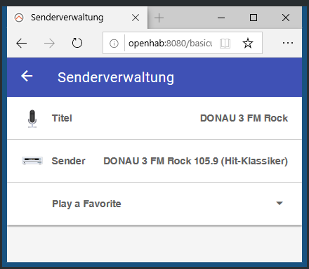

that is exact what i would like to have but i´m not successfull. in basic ui when entering the site that i call “stationmanagement” it looks pretty normal:
when i click the arrow to open the favourites list the only thing that happens is that the whole site becomes a little grey but nothing else happens (tested in firefox and edge):

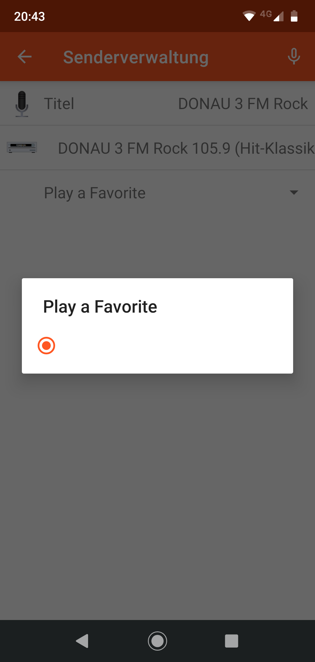

on openhab-app (android) i see this:
what am i doing wrong? my things file:
Bridge squeezebox:squeezeboxserver:squeezeboxServer [ ipAddress="x.x.x.x", webport=9000, cliport=9090 ]
    Thing squeezeboxplayer SqueezeboxPlayer [ mac="xx:xx:xx:xx:xx:xx", notificationTimeout=30, notificationVolume=75 ]
my items-file:
Switch iSbPlayer_AusEin "Squeezebox" { channel="squeezebox:squeezeboxplayer:squeezeboxServer:SqueezeboxPlayer:power" }
Player iSbPlayer_Funktionen "Navigation" <none> {channel="squeezebox:squeezeboxplayer:squeezeboxServer:SqueezeboxPlayer:control" }
Number iSbPlayer_Zufall "Zufallswiedergabe" <none> {channel="squeezebox:squeezeboxplayer:squeezeboxServer:SqueezeboxPlayer:currentPlaylistShuffle" }
Dimmer iSbPlayer_Laut "Lautstärke [%s]" { channel="squeezebox:squeezeboxplayer:squeezeboxServer:SqueezeboxPlayer:volume" }
String iSbPlayer_Titel "Titel [%s]" <microphone> { channel="squeezebox:squeezeboxplayer:squeezeboxServer:SqueezeboxPlayer:title" }
String iSbPlayer_Sender "Sender [%s]" <receiver> { channel="squeezebox:squeezeboxplayer:squeezeboxServer:SqueezeboxPlayer:remotetitle" }
String iSbPlayer_Favorit "Favorit Nr [%s]" <none> { channel="squeezebox:squeezeboxplayer:squeezeboxServer:SqueezeboxPlayer:playFavorite" }
String iSbServer_FavListe "Favoritenliste [%s]" { channel="squeezebox:squeezeboxserver:squeezeboxServer:favoritesList" }
and the sitemap:
Text label="Senderverwaltung" icon="squeeze"{
	Default item=iSbPlayer_Titel
	Default item=iSbPlayer_Sender
	Selection item=iSbPlayer_Favorit label="Play a Favorite"
