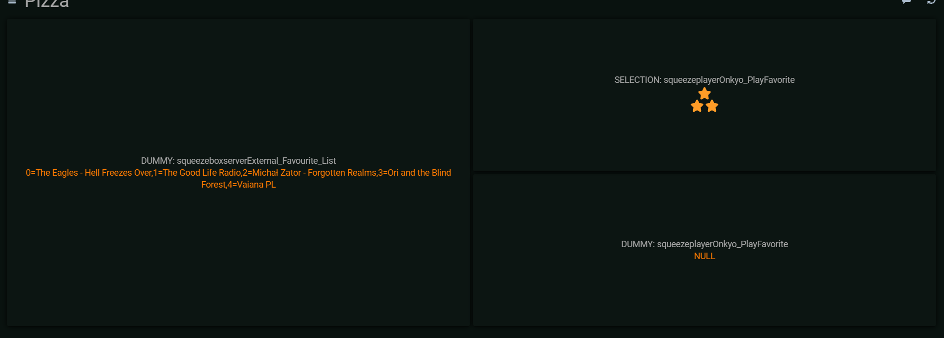

Hello, I have issue with the PlayFavorite which seems to not populate with selection widget neither in HABPanel nor in BasicUI. @mhilbush, did anything change recently in the binding or I have some error somewhere? It was working before correctly. I reinstalled binding and cleaned cache so far and still nothing. Item squeezeboxserverExternal_Favourite_List populates coreectly and I can see playlist in PaperUi or basicui, however it looks like there is lack of transport from squeezeboxserverExternal_Favourite_List to PlayFavorite.

String squeezeboxserverExternal_Favourite_List  "Favorities list [%s]" (Group_Squeezebox,Group_HabPanel_Dashboard) { channel="squeezebox:squeezeboxserver:external:favoritesList" }
String squeezeplayerOnkyo_PlayFavorite "Ulubione [%s]" (Group_Player_Salon,Group_HabPanel_Dashboard) { channel="squeezebox:squeezeboxplayer:external:squeezeplayerOnkyo:playFavorite" }
sitemap
Selection item=squeezeplayerOnkyo_PlayFavorite          label="Favorities"
Nothing has changed in the binding for quite a long time.
Looking at the info you posted, your channel definition for item chromecastplayerSalon_PlayFavorite doesn’t match any of the squeezeboxplayer things in your things file.
Sorry I’ve made a mistake and put as an example the wrong item associated to player which I’ve removed from the things file some time ago but it still remains in the item file. Updated my post with the correct one item. Situation does not change. I’ve set debug to Trace and here is what happens after adding new item to playlist.
I did debug to trace but can’t see anything wrong :confused:

And here there is screenshot from habpanel:
Everything looks completely normal to me.

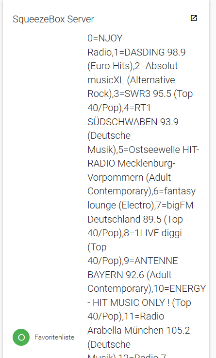

hi mark,
as additional info: perhaps you remember my post last year where i had the same issue:
i tried quite a lot but i couldn´t get it work then so i gave up and left this feature.
meanwhile i installed openhabian completely from scratch, not quite sure if it is the same hardware, actually i use a raspberry 4b (4 gb) maybe then i still had a raspberry 2b working.
but now i tried again and find the playfavorite is working. i did not try it for a long time and now i am happy to see everything is fine.
best, stefan
