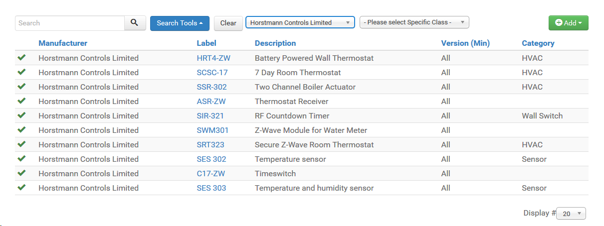

But the first issue is that the SRT321 is identified by openHAB as SRT323. When I read the docs, it should instead be of the type HRT4-ZW.
Is there someway to change this? Everything got identified automatically and I didn’t see any option to change the type.
I did some more digging and I have a SRT-321 GEN-5. Thee seems to be a number of different versions of the SRT-321.
My device has 6 association channels, compared to 5 for HRT4-ZW and SRT-323.

Thanks for your input. I found the same combination of manufacturer, id & type as SRT323, however it is not the same device. I’d really appriciate some help in getting this one into the database.

If your device is a SRT321 with type and id 0001:0005, this type and id were added to the wrong device in the database (SRT323).
But we need to be careful to not break other users configs.
As the associations groups are already different I guess the configuration options are also different.
Yes, to add the device to the database we need a pdf manual and a product image.

Thanks. The SRT321 has different associations groups compared to the SRT323, so I decided to make a new database entry for the SRT321 and remove the thing/device id from SRT 323:
https://www.cd-jackson.com/index.php/zwave/zwave-device-database/zwave-device-list/devicesummary/989
Also the default value for config parameter 1 is different.
