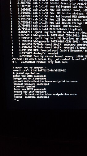

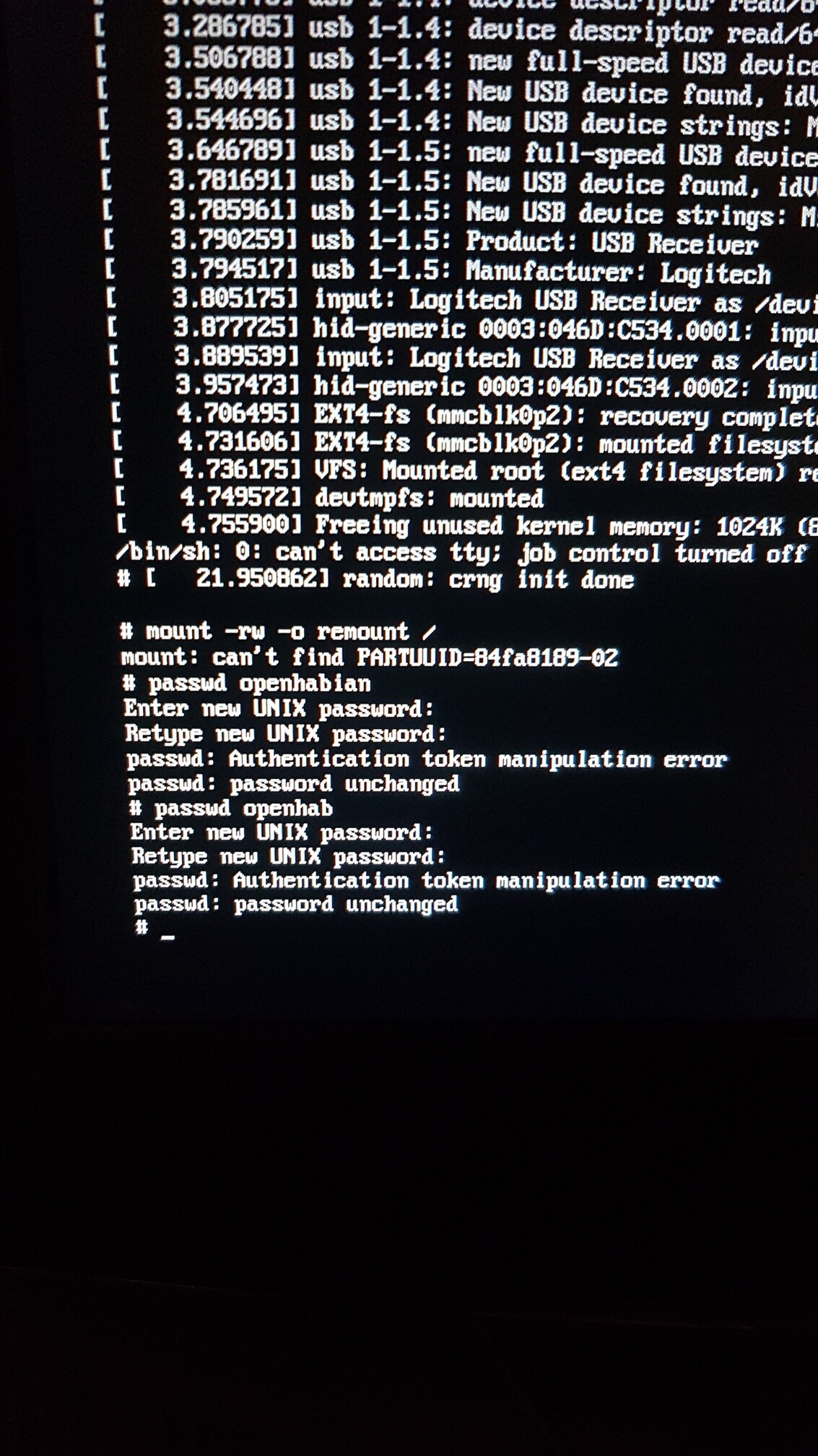

  1. When I reach the ‘mount -rw -o remount /’ I get an error:
    “mount: can´t find PARTUUID=84fa8189-02”
  2. I went futher anyway and entered the passwd openhabian, after that, beeing promted to enter new password and retype password.
    After that I get a new error:
    “passwd: Authentication token maipulation errro” Passwd: password unchanged".

An image from the monitor of the Rpi is supplied as well.

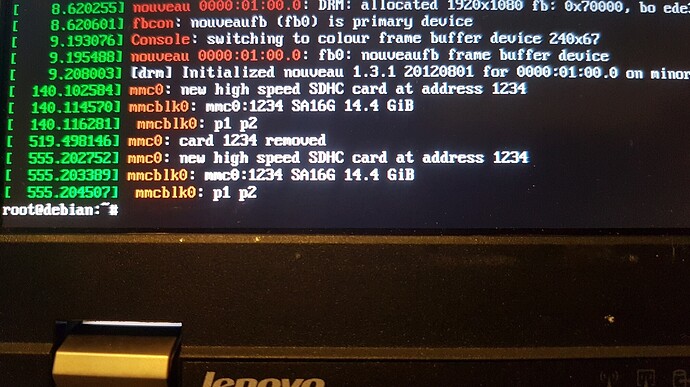

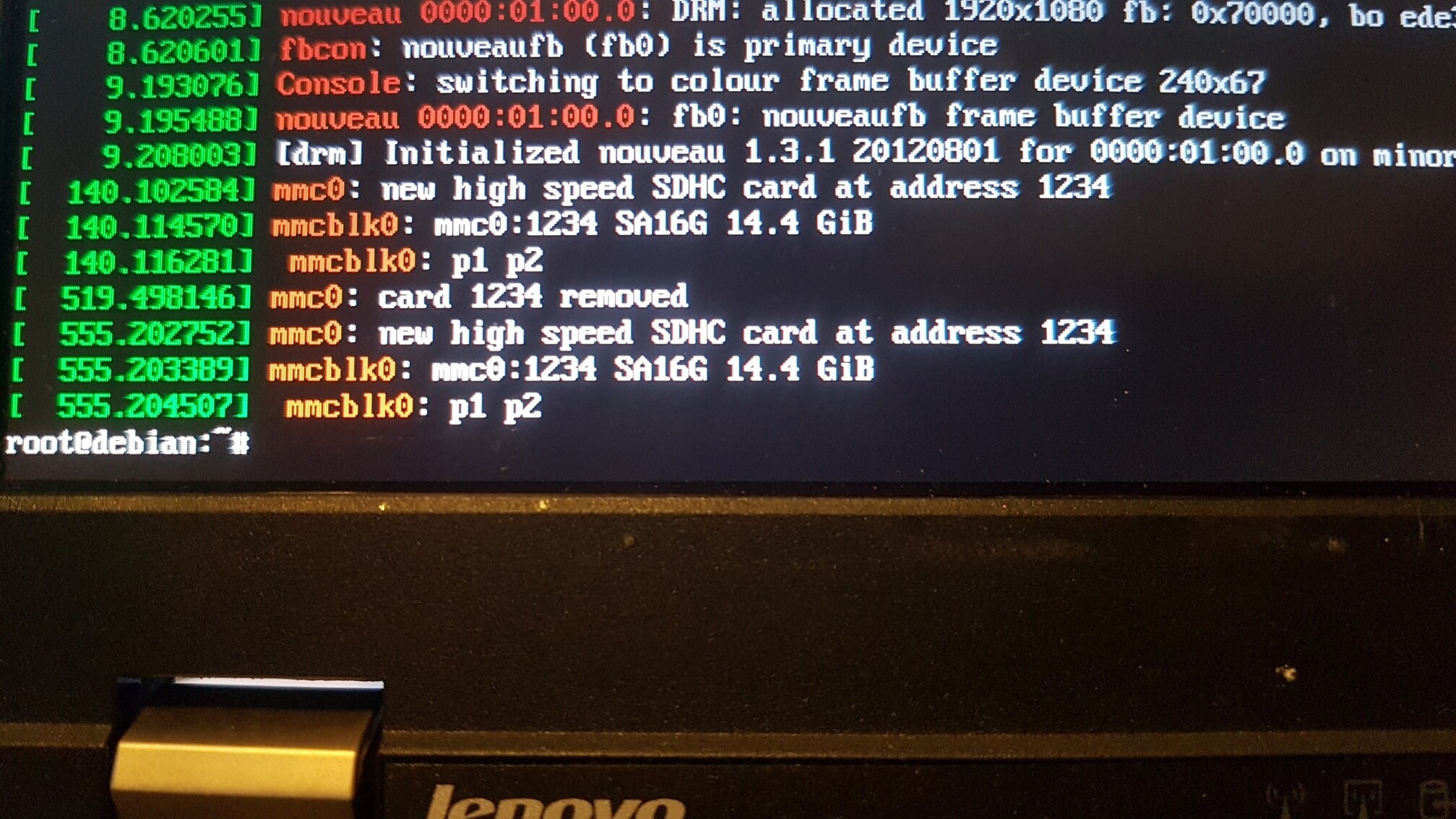

Got a new debian up running. Inserted the SDCard, and after the dmegs I do se the SD Card allrigth, but I cant seemt to mount it.. It´s no reconized as a scd2 or sdc3..
I only have the USB stick and the SD card connected.
If I try to mount the mmcblk0 I get an error:
mount: “wrong fs type, bad option, bad superblock on dev/mmcblk0, missing codepage or helper program, or other error”
Got a little futher now.. Found out what partion to mount. It was mmcblk0p2 :slight_smile:
Found it by running a fdisk -l
