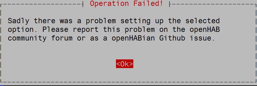

  1. Cannot install influxdb:
    When installing influx manually, /usr/bin/influx is missing.
  2. openhabian-system setting: change openhabian user password does not work because it always says that new password does not match.
  3. Starting OH with sudo systemctl start openhab2.service kind of hangs (does not return to bash)

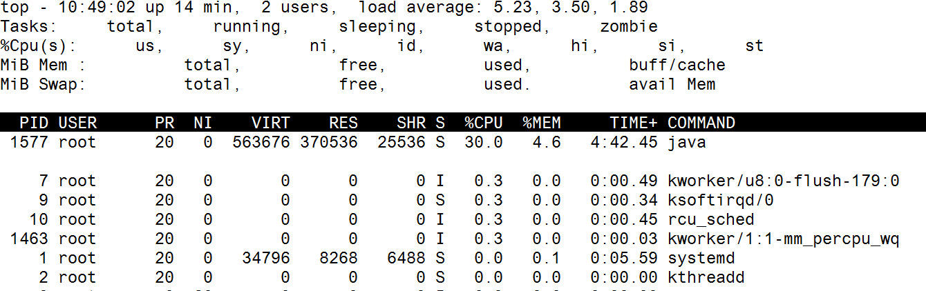

EDIT:
If I start openhab in the console (sudo openhab-cli start) I don’t see openhab in “top” (just java):
And I don’t see the syslog in Browser (port 9001) is not available, but PaperUI works.
Furthermore I get in the colsole:
openhab> Experimental:  JNI_OnUnload called.
And even though OH seems to be running in the console (PaperUI still working).
I get the latest entry in events.log 20 minutes ago:
2020-09-20 10:53:06.469 [thome.event.ExtensionEvent] - Extension 'binding-icloud' has been uninstalled.
2020-09-20 10:53:12.378 [hingStatusInfoChangedEvent] - 'systeminfo:computer:homer' changed from ONLINE to UNINITIALIZED
2020-09-20 10:53:12.403 [hingStatusInfoChangedEvent] - 'systeminfo:computer:homer' changed from UNINITIALIZED to UNINITIALIZED (H$
2020-09-20 10:53:12.546 [thome.event.ExtensionEvent] - Extension 'binding-systeminfo' has been uninstalled.
2020-09-20 10:53:17.742 [thome.event.ExtensionEvent] - Extension 'binding-wol1' has been uninstalled.
and in openhab.log:
2020-09-20 10:51:48.153 [WARN ] [ig.xml.osgi.XmlDocumentBundleTracker] - The XML document '/ESH-INF/thing/yale/yrl256_1_78.xml' i$
com.thoughtworks.xstream.io.StreamException:  : Exception in opening zip file: /var/lib/openhab2/cache/org.eclipse.osgi/265/0/bun$
        at com.thoughtworks.xstream.io.xml.StaxDriver.createReader(StaxDriver.java:126) ~[bundleFile:?]
        at com.thoughtworks.xstream.XStream.fromXML(XStream.java:1115) ~[bundleFile:?]
        at com.thoughtworks.xstream.XStream.fromXML(XStream.java:1062) ~[bundleFile:?]
        at org.eclipse.smarthome.config.xml.util.XmlDocumentReader.readFromXML(XmlDocumentReader.java:85) ~[bundleFile:?]
        at org.eclipse.smarthome.config.xml.osgi.XmlDocumentBundleTracker.parseDocuments(XmlDocumentBundleTracker.java:411) [bund$
        at org.eclipse.smarthome.config.xml.osgi.XmlDocumentBundleTracker.processBundle(XmlDocumentBundleTracker.java:398) [bundl$
        at org.eclipse.smarthome.config.xml.osgi.XmlDocumentBundleTracker.access$6(XmlDocumentBundleTracker.java:393) [bundleFile$
        at org.eclipse.smarthome.config.xml.osgi.XmlDocumentBundleTracker$2.run(XmlDocumentBundleTracker.java:363) [bundleFile:?]
        at java.util.concurrent.Executors$RunnableAdapter.call(Executors.java:511) [?:1.8.0_265]
        at java.util.concurrent.FutureTask.run(FutureTask.java:266) [?:1.8.0_265]
        at java.util.concurrent.ScheduledThreadPoolExecutor$ScheduledFutureTask.access$201(ScheduledThreadPoolExecutor.java:180) $
        at java.util.concurrent.ScheduledThreadPoolExecutor$ScheduledFutureTask.run(ScheduledThreadPoolExecutor.java:293) [?:1.8.$
        at java.util.concurrent.ThreadPoolExecutor.runWorker(ThreadPoolExecutor.java:1149) [?:1.8.0_265]
        at java.util.concurrent.ThreadPoolExecutor$Worker.run(ThreadPoolExecutor.java:624) [?:1.8.0_265]
        at java.lang.Thread.run(Thread.java:748) [?:1.8.0_265]
Caused by: java.io.IOException: Exception in opening zip file: /var/lib/openhab2/cache/org.eclipse.osgi/265/0/bundleFile
        at org.eclipse.osgi.framework.util.SecureAction.getZipFile(SecureAction.java:321) ~[org.eclipse.osgi-3.12.100.jar:?]
        at org.eclipse.osgi.storage.bundlefile.ZipBundleFile.basicOpen(ZipBundleFile.java:93) ~[org.eclipse.osgi-3.12.100.jar:?]
        at org.eclipse.osgi.storage.bundlefile.ZipBundleFile.getZipFile(ZipBundleFile.java:106) ~[org.eclipse.osgi-3.12.100.jar:?]
        at org.eclipse.osgi.storage.bundlefile.ZipBundleEntry.getInputStream(ZipBundleEntry.java:59) ~[org.eclipse.osgi-3.12.100.$
        at org.eclipse.osgi.storage.url.BundleURLConnection.connect(BundleURLConnection.java:53) ~[org.eclipse.osgi-3.12.100.jar:$
        at org.eclipse.osgi.storage.url.BundleURLConnection.getInputStream(BundleURLConnection.java:99) ~[org.eclipse.osgi-3.12.1$
        at java.net.URL.openStream(URL.java:1068) ~[?:1.8.0_265]
        at com.thoughtworks.xstream.io.xml.StaxDriver.createReader(StaxDriver.java:109) ~[bundleFile:?]
        ... 14 more
Caused by: java.io.FileNotFoundException: /var/lib/openhab2/cache/org.eclipse.osgi/265/0/bundleFile (No such file or directory)
        at java.util.zip.ZipFile.open(Native Method) ~[?:1.8.0_265]
        at java.util.zip.ZipFile.<init>(ZipFile.java:230) ~[?:1.8.0_265]
        at java.util.zip.ZipFile.<init>(ZipFile.java:160) ~[?:1.8.0_265]
        at java.util.zip.ZipFile.<init>(ZipFile.java:174) ~[?:1.8.0_265]
        at org.eclipse.osgi.framework.util.SecureAction.getZipFile(SecureAction.java:304) ~[org.eclipse.osgi-3.12.100.jar:?]
        ... 14 more
In the console I still can call bundles:list, but the logs don’t show any activity.
In messages I see a lot of ZRAM related stuff which does not look well (write error):
@mstormi Any idea about this?
Is it possible that the sd-card has an issue (almost brand new)

After a fresh image on 8GB and a restart I cannot even upgrade:
And openhab is obviously not installed - maybe this is related to the 8GB only?!
