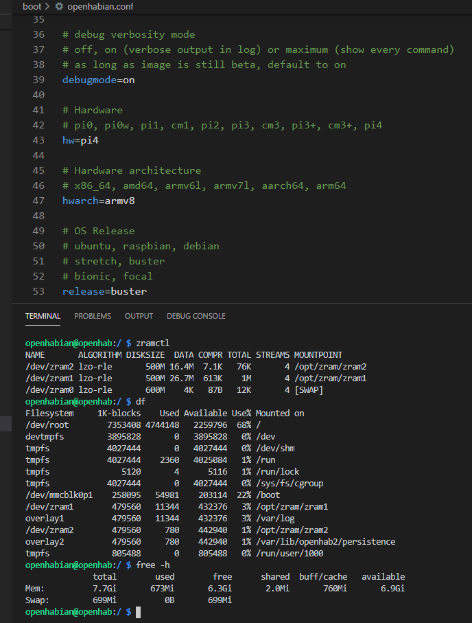

This statement was about the 8GB card.
The 32 GB card does have OH installed but it’s not running.
That’s my major issue and debugging is this was I currently try.
So I left it do its thing without touching it and I got to zram install.
http://openhab/
Shows

It looks to be a hardware issue with the Kernel so not a openhabian issue but it is failing.
Heard about this from someone else seem to be specific about 8GB RPi
(never a good idea to use latest’n greatest, in particular when it comes to HW you cannot change)
Try zraminstall=disable in /boot/openhabian.conf
I installed a new Raspi4 with 8 GB RAM from scratch.
When installing ZRAM using openhabian-config tool I got:
Internal error: Oops: 207 [#1] SMP ARM
…and I got the same kernel messages as described by @denominator.
Is this related to the 8GB RAM?
Thanks.
I did this and the zram messages disappeared.
Starting OH still does not work (openhab.log):
2020-09-20 19:28:25.611 [SEVERE] [org.apache.karaf.main.Main] - Could not launch framework
java.lang.RuntimeException: Error initializing storage.

Ok I have done some poking around and now have zram working. (I think)
I installed the v1.6-alpha/openhabian-pi-raspios64beta-202007302224-git0290f04-crc93729328.img
Edited the /boot/openhabian.conf file and put in pi.

So you say it does not happen with the 64bit version but with the 32bit one it does ?
Interesting.
But don’t use 64bit image in production. It’s completely untested.
Yeah can confirm it did all install properly with the 64bit version.
My production openhab is on rpi3 b+ with msata drive.
I going to run the pi4 with oh3 to do testing and learn more so I can be more helpfull.
Kernel version tested
hostnamectl | grep Kernel
Kernel: Linux 5.4.51-v8+
Won’t do ![]()
