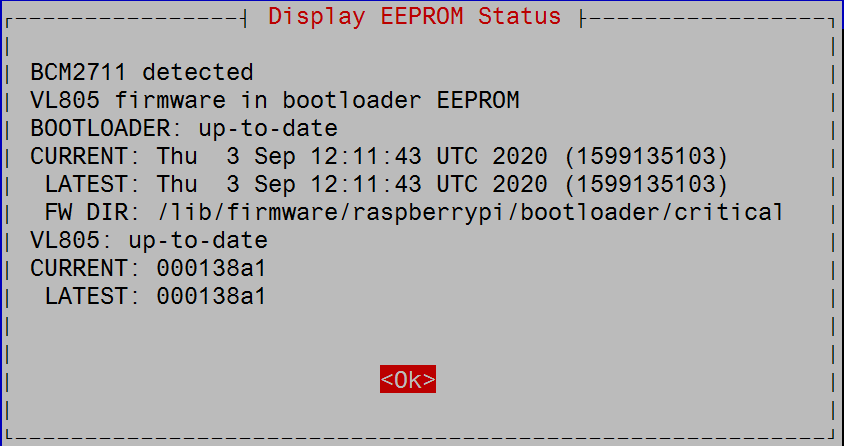

If you choose to use an SSD, make sure you have the latest firmware as at initial release there was no support for USB booting. There is a “Raspberry Pi EEPROM Manager” shell script that can help with that. You can find a link to it here:
I just set this up yesterday on my Pi4.

Looks ok, right?

Yes, that’s the latest firmware.
