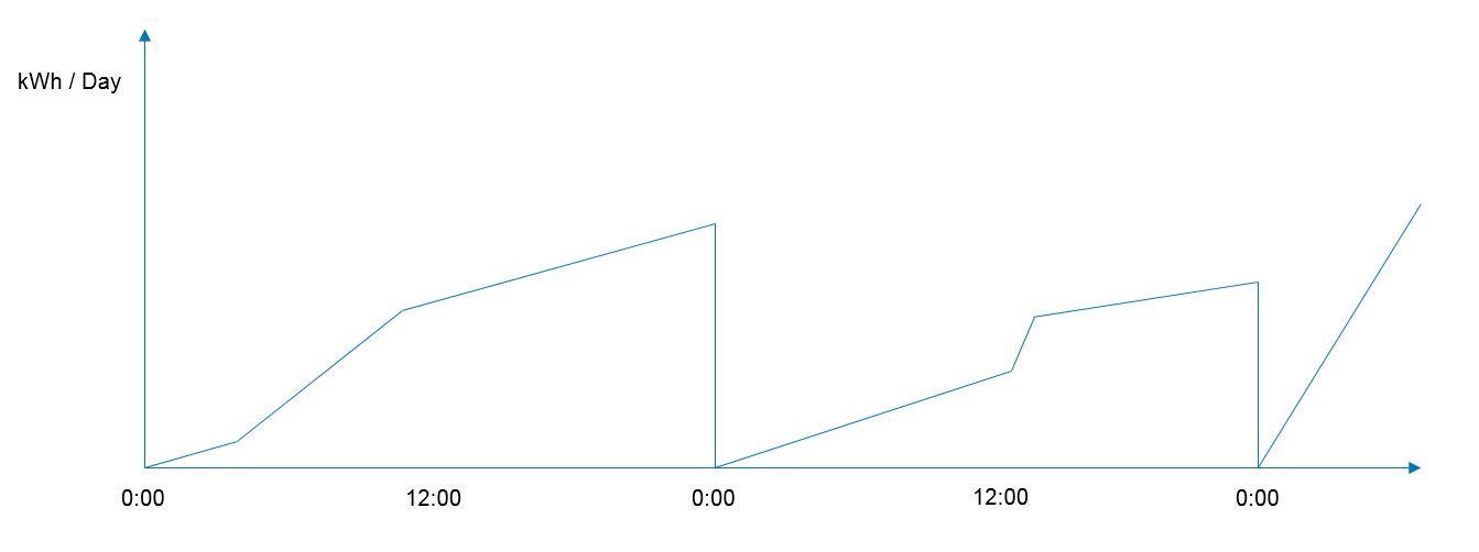

No. The only way this would work would be to only sum the value at midnight just before it resets to zero. You could do this in a Rule.

How is this item updated in the first place. I would think that those daily values are summed up already, can’t you use the same technique for a month

It is possible to get all these items per month as well…was just thinking/trying to do something in the most effiicient and easiest way. And for sure to learn But I already expected that my first idea does not work. So I will follow the way to have the value for every item per month and then do the calculations.
