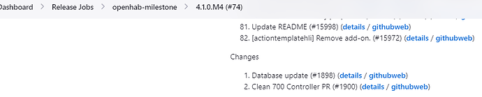

Also since I had a hand in the PR, I have run with 700 controllers in OH for several months. (There was a late change during the review that wasn’t tested long, but seems okay.) It would be good to get feedback before OH4.1 in case something needs to be fixed.

I tried using the Aeotec Gen7 Stick. The Nodes are already added to the controller. I stopped zwave-js-ui and added the Gen7 Stick to OH. The Stick got online. Yeah.
I then tried to add the Nodes. The nodes showed up in my inbox but didn’t show any further informations. Even the name did not change and all nodes showed up like “Node 7”.
I added some Nodes for testing but they wohn’t get online.
