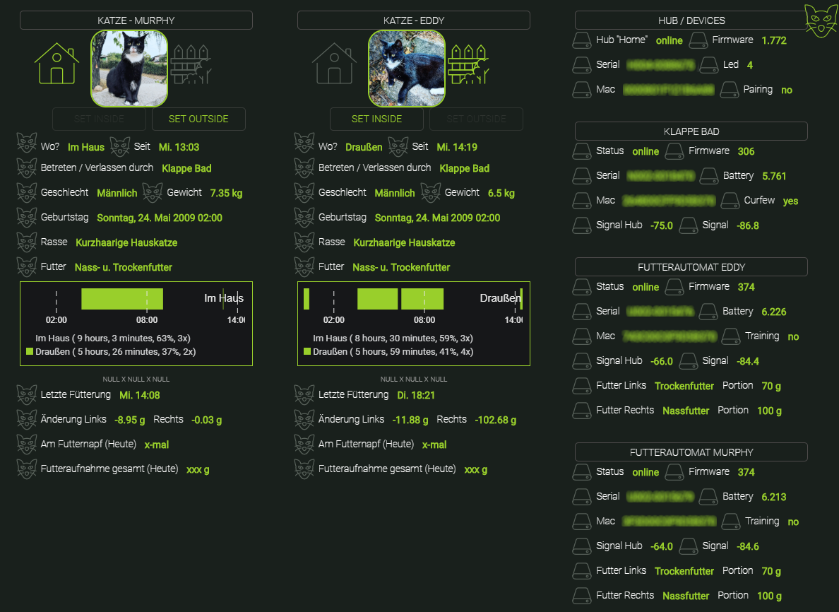

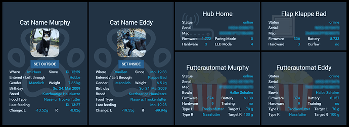

I finally have a working solution for my connected cat flap from Sure Petcare This soultion is not the very best way… but it works :slight_smile:
I tried to do this with a binding, but havent success, so i stick with this ruels for now… maybe some Dev can create a binding in the future.
Note: I’m running on the latest Snapshot builds with JSR223 Rules and I’m using HABPanel…
If you are on another version of openHAB or if you are using BasicUI, you may need to adjust the following steps a bit…
This is for testing only… if you found bugs or find a better way to do things, please let me know in the comments.
You also nee to get you Auth token and need to insert it into the 3 jsr223 rules (explained below).
Look in Matrix Theme (outdated)
Look in Basic HABPanel widgets
This is what works so far:
  • polls the main catflap data every 6 hours (there are not much changing)
  • polls the pet location (and pet feeder data if available) every 5 minutes
  • you can set the status of the cat through openHAB
  • for now only 1 household is supported
  • if you have multiple users in your sure petcare account, openhab shows which user set the cat status manually via sure petcare app (f.e. if you have pet sitters)
  • otherwise the device name (where the cat entered/left the house) is shown
  • map transform file to translate into your language
  • device status of your Hub and Cat Flap and Pet Feeder devices
