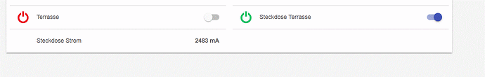

I have a KNX switch actor which can measure the electrical current.
Currently I have two items, a number item and the actual switch item:
Switch Steckdose_Outdoor_Terrasse "Steckdose Terrasse"            (gOutdoor) { knx="12/3/20+<13/3/20" }
Number Steckdose_Outdoor_Terrasse_Strom "Steckdose Strom [%d mA]"       (gOutdoor) { knx="<7.012:5/3/21" }
Instead of the static name “Steckdose Terrasse” I would prefer “Steckdose Terrasse, Strom: 2483 mA” to have one item less.
I still need the switch button though.
Has anyone an Idea how to achieve this?
BR
Marco
