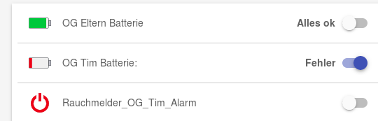

Switch Rauchmelder_OG_Tim_Fehler_Batterie "OG Tim Batterie: [MAP(rauchmelder.map):%s]" <battery> (gRauchmelder) { knx="<(10)31/3/14" }
and in the sitemap:
Group item=gRauchmelder label="Rauchmelder"
results in:
So I dont want and need the actual switch button but only the text and the icon. The icon change itself is working out of the box. I want to avoid rules if possible to achieve this.
Does anyone have an Idea how to achieve this?
When using a Group element in a sitemap, the items in the group will be displayed with their corresponding element type.
https://docs.openhab.org/configuration/sitemaps.html#element-type-group
You will need to replace the Group element with the individual items. Putting them in a Block will give the same visual appearance as a Group element, and using Text elements should give the effect you want for the items.
Text label="Rauchmelder" {
    Text item=OG_Eltern_Batterie
    Text item=OG_Tim_Batterie
    Text item=Rauchmelder_OG_Tim_Alarm
Hello Scott,
that does the trick, thank you very much.
