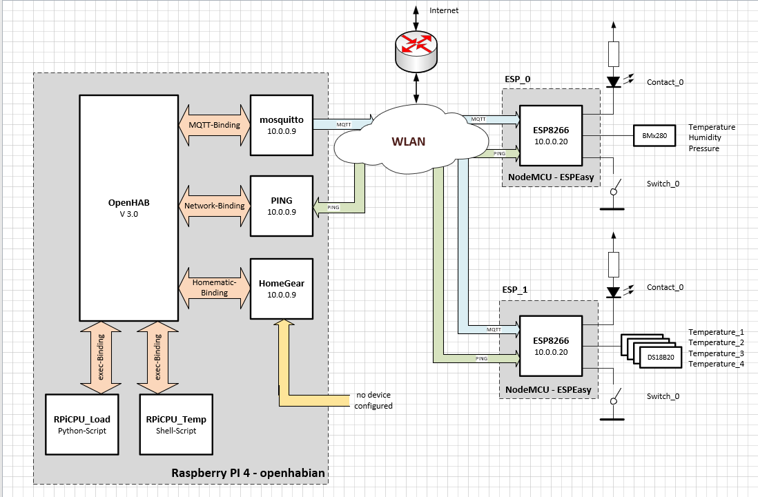

- Hardware: RPi 4
- OS: openhabian 3
- Java 11
- openHAB version: 3
I have setup a simple system set up using a Raspberry Pi 4 and two NodeMCUs (ESP8266) connected over a WLAN to measure temperatures (see figure).
I also prepared a Homatic-binding, but no devices are configured.
Additionally, I supervise the network connection to the NodeMCUs and I am supervising the RPi.
In order to determine the CPU-load and the CPU-temperature I execute two different scripts using the exec-binding ever 10 seconds. The systeminfo-binding does not support the CPU-load for the Raspberry.
