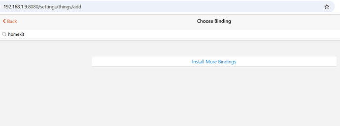

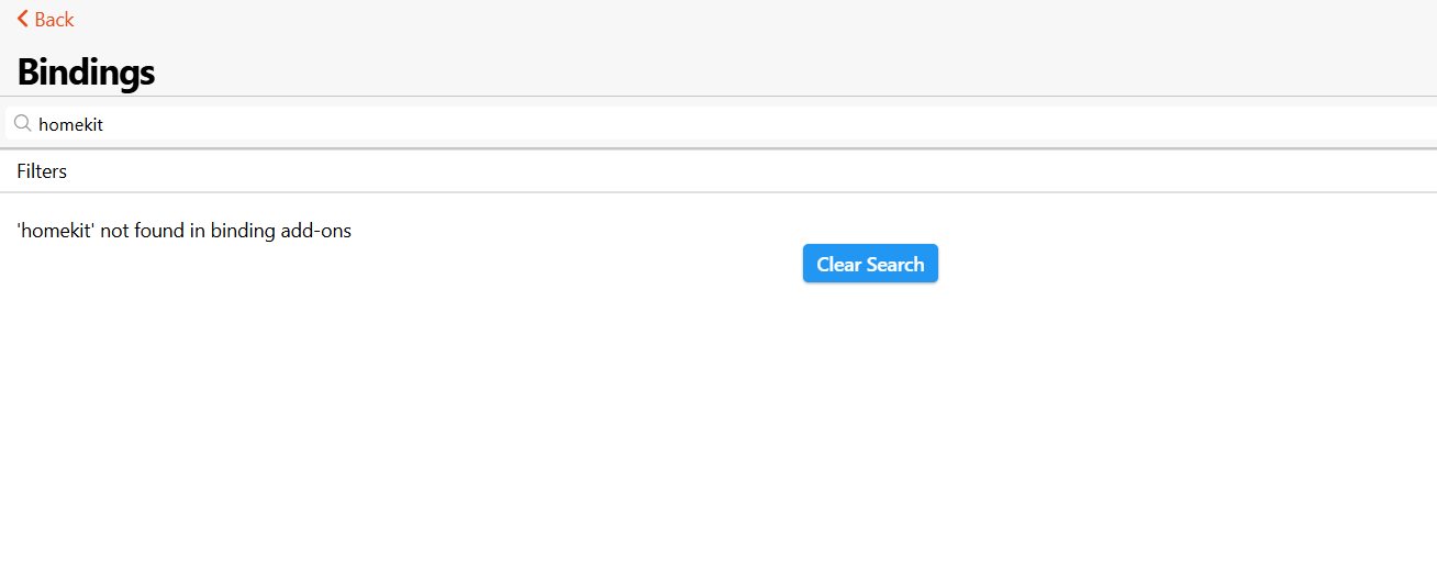

I’ve got the jar installed, and no errors appeared.
openhab> bundle:list | grep -i homekit
370 │ Installed │  80 │ 5.1.0.202510301735    │ openHAB Add-ons :: Bundles :: HomeKit Client Binding
However, the binding doesn’t show up anywhere:
So something is wrong, it seems.
(Maybe a dedicated topic for the Homekit binding would be better?)
I have the same issue. Might be related to this error:
your code goes here2025-10-31 09:34:27.995 [ERROR] [Events.Framework                    ] - FrameworkEvent ERROR
org.osgi.framework.BundleException: Could not resolve module: org.openhab.binding.homekit [354]
  Unresolved requirement: Import-Package: com.google.gson; version="[2.13.0,3.0.0)"
