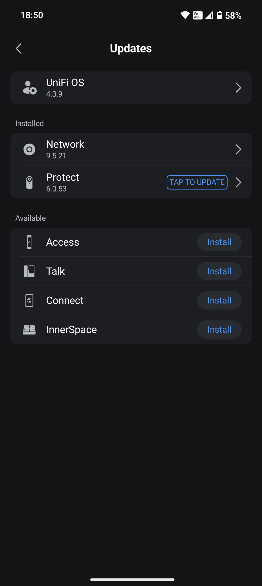

@Punsher @ErikDB
From past posts, it’s clear that you both use UniFi network components. There’s currently a bug in the access point firmware 6.7.33 (stable for U6) that prevents multicast from working. Just a thought.
I’m afraid to update anything Unifi related… So I’m here:
In my case the server running OH and the tado bridge are both connected to the same non unifi switch. I don’t know if that could block multicast. And would the pairing even use multicast? Discovery works just fine after all.
I don’t know, but I wouldn’t expect that.
