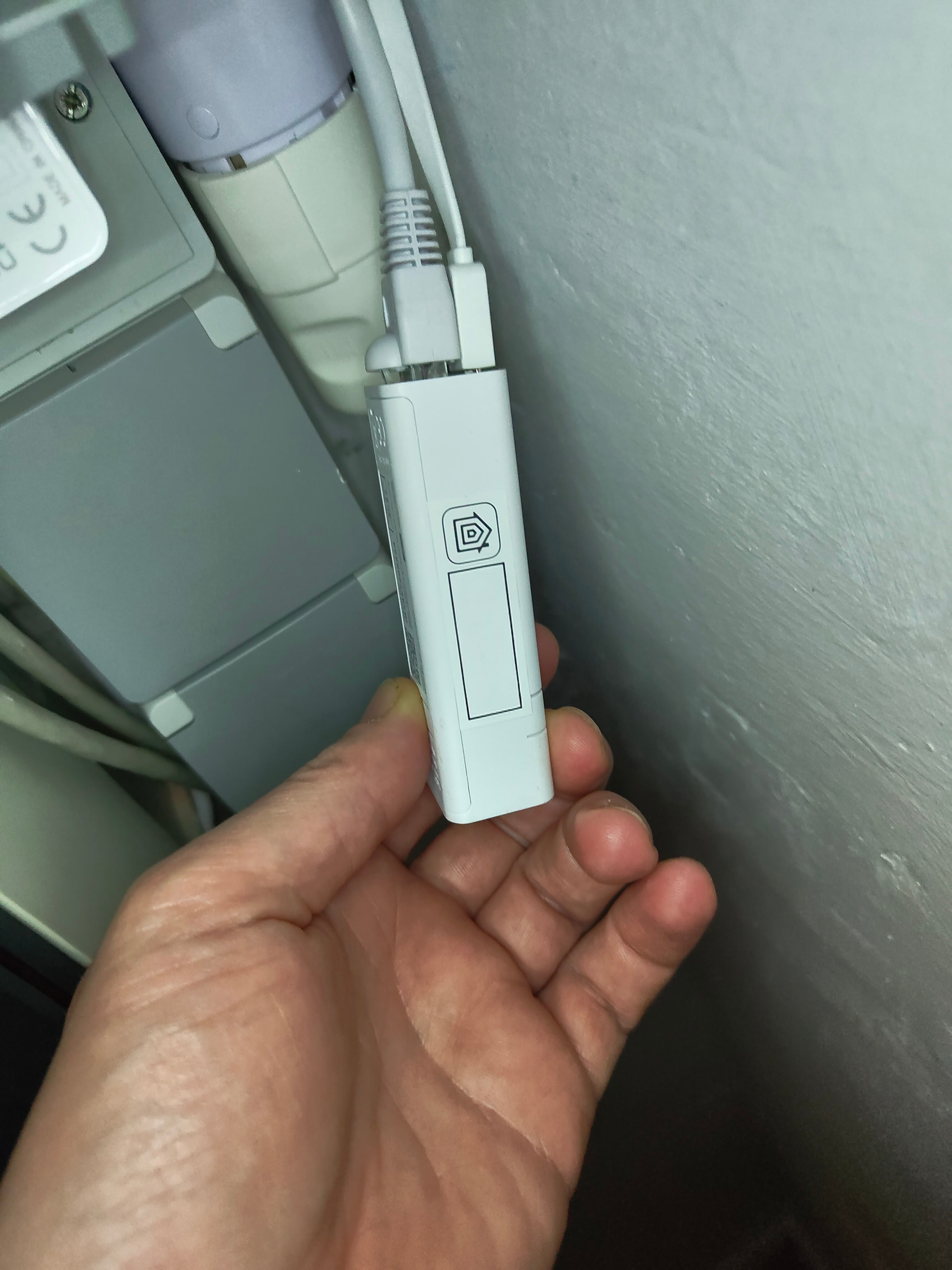

Where should I get that pairing code from?
There is a sticker on the bridge with the Apple home symbol and the code
The number in this box, I assume? (I erased it on the picture, there is an 8-digit number.)

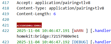

Somewhere in there, there are characters VS Code can’t read:

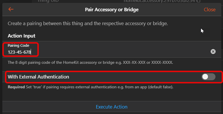

In HomeKit there are two forms of pairing:
  1. Simple pairing. This works directly between two devices – a HomeKit client (the binding) and a HomeKit accessory. In this case you need only to enter the pairing code in the binding, and the rest is automatic.
  2. Pairing with external authorization. In addition to the HomeKit client (the binding) and the HomeKit accessory (the Tado bridge), it requires an additional third party to put the accessory into pairing mode. In the case of the Tado bridge the additional third party can be either a) using the Tado app to put the bridge into pairing mode, or b) pressing the pairing button on the Tado bridge.
So @ErikDB you probably do not need an iPhone or anything Apple related, so long as you can use a) or b) above.
HOWEVER yesterday I uploaded a new version of the binding Jar to the PR location, where pairing is done via a Thing Action. See the screenshots below..

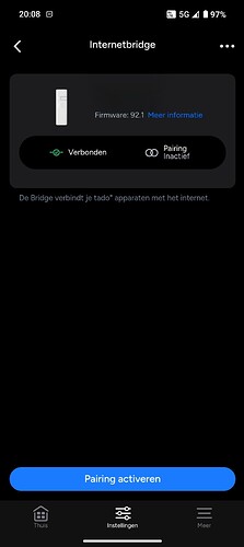

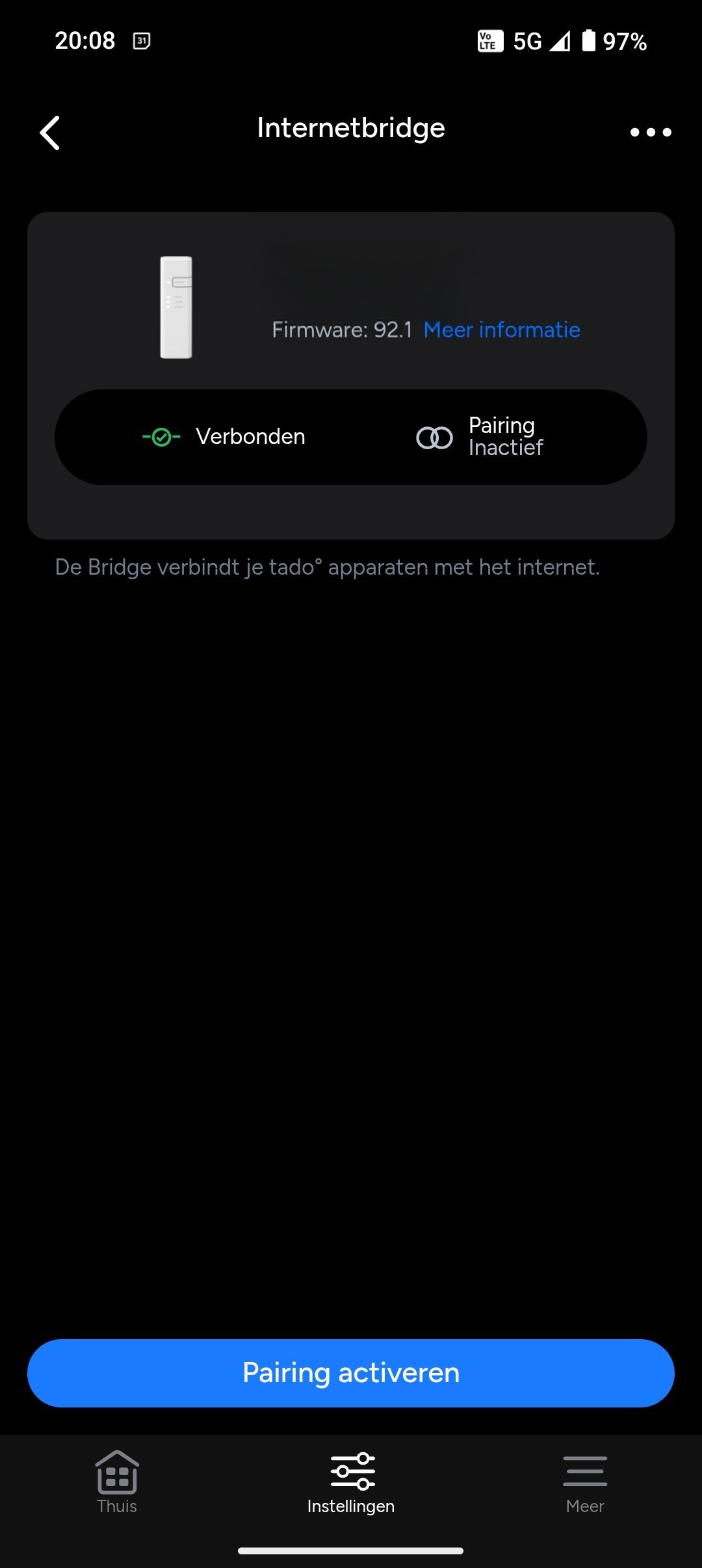

And when you do the pairing, you need to set the Tado bridge into pairing mode, and then enter the Thing Action details as below. NOTA BENE: I am not 100% sure if “With External Authentication” should be on or off – most probably on but try both..
I see. This explains the timeout.

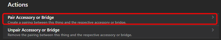

I suppose this is what I need to do:
I’ll update the jar tomorrow, and give this a go! I’ll start with “With External Authentication” OFF, as that is probably the setting that will fail. Right?
Done just now.
I just tried with the new version and the flag in both states … without any luck. Also I guess the pairing button for the bridge allows to pair new tado devices. The instructions for pairing homekit don’t mention it as well. How do I set up tado° with Apple HomeKit? | Help Center for tado° V3+ and earlier devices

2025-11-05 14:08:04.426 [DEBUG] [mekit.internal.transport.IpTransport - 1115      ] - Connecting to 192.168.1.70:80
2025-11-05 14:08:04.434 [DEBUG] [mekit.internal.transport.IpTransport - 1115      ] - Connected to 192.168.1.70:80
2025-11-05 14:08:04.434 [DEBUG] [.handler.HomekitBaseAccessoryHandler - 1115      ] - Starting Pair-Setup for homekit:bridge:72157980e9e1
2025-11-05 14:08:04.435 [DEBUG] [nternal.hap_services.PairSetupClient - 1115      ] - Created with pairing code: XXXXXXXX
2025-11-05 14:08:04.435 [DEBUG] [nternal.hap_services.PairSetupClient - 1115      ] - Pair-Setup M1: Send pairing start request to server
2025-11-05 14:08:04.435 [TRACE] [nternal.hap_services.PairSetupClient - 1115      ] -
 - 0x06: 01 {1}
 - 0x00: 01 {1}
2025-11-05 14:08:04.435 [TRACE] [mekit.internal.transport.IpTransport - 1115      ] - HTTP request:
POST /pair-setup HTTP/1.1
Host: 192.168.1.70:80
Accept: application/pairing+tlv8
Content-Type: application/pairing+tlv8
Content-Length: 6
Connection: keep-alive
2025-11-05 14:08:14.437 [WARN ] [.handler.HomekitBaseAccessoryHandler - 1115      ] - Pairing / verification failed 'null' for homekit:bridge:72157980e9e1
2025-11-05 14:08:14.438 [DEBUG] [.handler.HomekitBaseAccessoryHandler - 1115      ] - Stack trace
java.util.concurrent.TimeoutException: null
