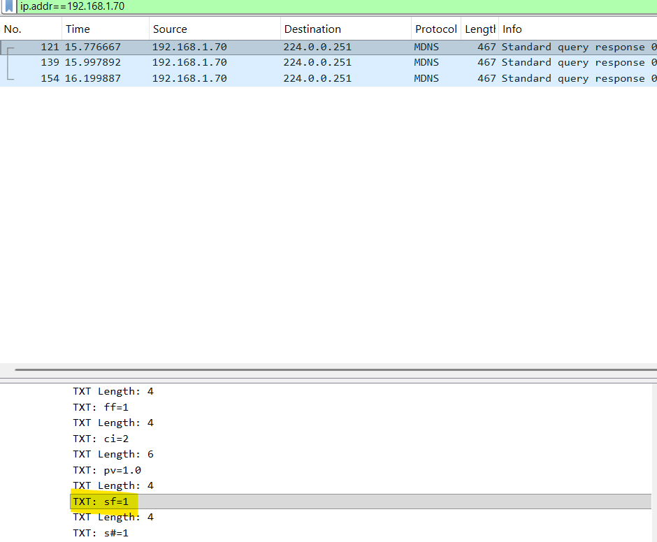

Maybe the bridge is (notwithstanding your protestations) already paired? If you have an mDNS discovery app or Bonjour you can check this by looking at the sf parameter in the bridges advertisement. (sf=0 means already paired and sf=1 means ready to pair).

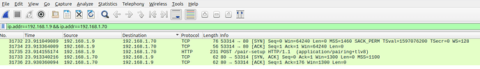

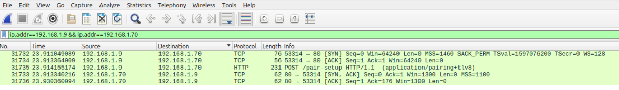

Maybe the bridge IS responding in some way but the binding is not seeing the response. Perhaps you could do a Wireshark capture?

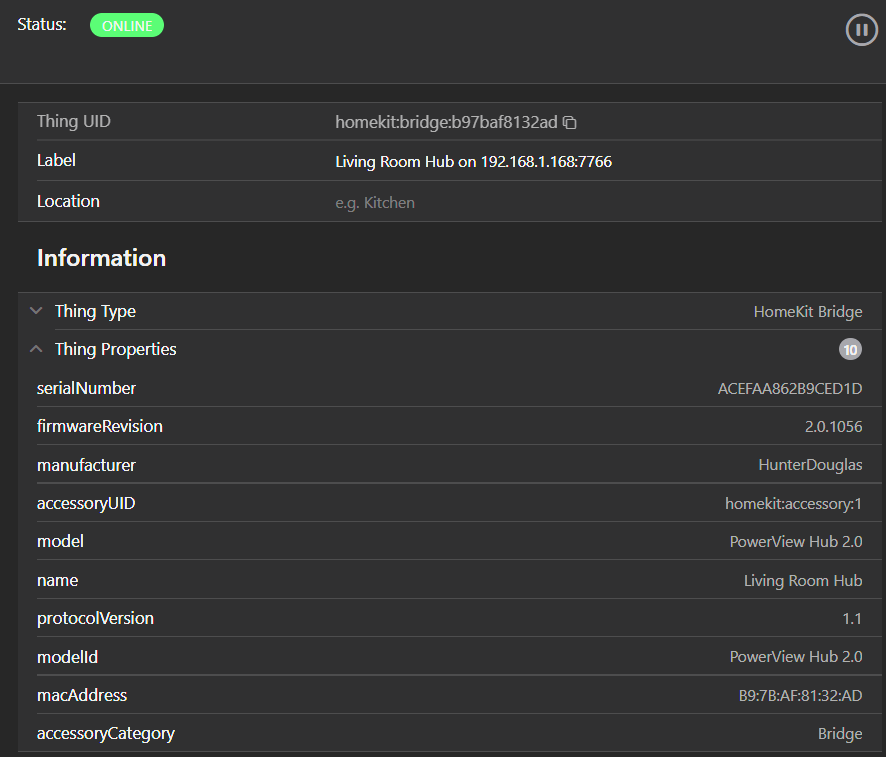

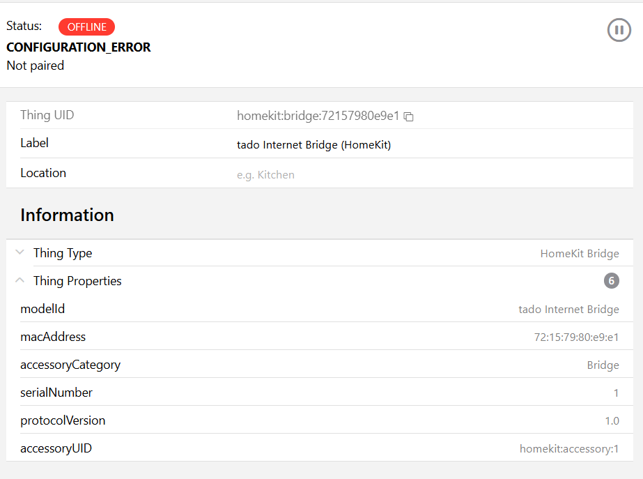

Perhaps you can anyway share a screen shot of the thing properties e.g. as below..

Did some further investigation as far as I can tell the bridge is at fault. The bridge simply does not reply to the pairing request. Did some checking with the AI. Only thing that might still be a cause is an issue where the bridge might prefer ipv6. But that might be a red hering.
