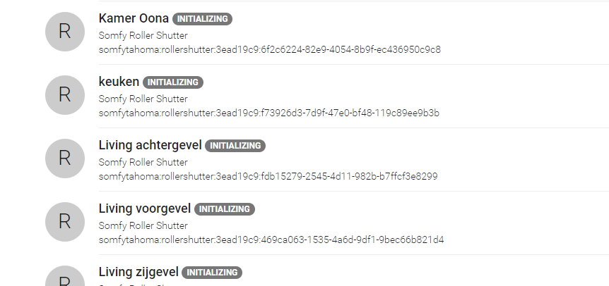

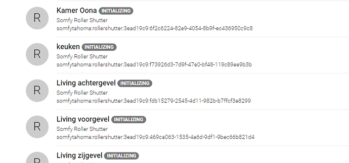

Hi all,
I hope people can advise me or point me in the right direction to further investigate my issue.
As I am making my way through Openhab and the Tahoma binding.
The issue started after Somfy updated their app to the new API.
The timers within the app were used, and only when manual intervention was needed I use the Tahoma binding.
Now both timers within the app, and Openhab are struggling with the following what ends up in random functionality.
Binding/shutter are offline.
Too many requests error, suspending activity for 120 seconds
2019-12-23 08:50:10.669 [DEBUG] [nal.handler.SomfyTahomaBridgeHandler] - Cannot get login cookie!
java.util.concurrent.TimeoutException: Total timeout 5000 ms elapsed
** at org.eclipse.jetty.client.HttpDestination$TimeoutTask.onTimeoutExpired(HttpDestination.java:529) ~[?:?]**
** at org.eclipse.jetty.io.CyclicTimeout$Wakeup.run(CyclicTimeout.java:282) ~[?:?]**
** at java.util.concurrent.Executors$RunnableAdapter.call(Executors.java:511) [?:1.8.0_212]**
** at java.util.concurrent.FutureTask.run(FutureTask.java:266) [?:1.8.0_212]**
** at java.util.concurrent.ScheduledThreadPoolExecutor$ScheduledFutureTask.access$201(ScheduledThreadPoolExecutor.java:180) [?:1.8.0_212]**
** at java.util.concurrent.ScheduledThreadPoolExecutor$ScheduledFutureTask.run(ScheduledThreadPoolExecutor.java:293) [?:1.8.0_212]**
** at java.util.concurrent.ThreadPoolExecutor.runWorker(ThreadPoolExecutor.java:1149) [?:1.8.0_212]**
** at java.util.concurrent.ThreadPoolExecutor$Worker.run(ThreadPoolExecutor.java:624) [?:1.8.0_212]**
** at java.lang.Thread.run(Thread.java:748) [?:1.8.0_212] **
As people were speaking about too many requests, the ā€œrefreshā€ and ā€œstatus time outā€ was brought back to 300.
As well as the debug logs, as network dump showing in my opinion that I connect every 5 min and still getting the above errors.
Any help from the audience is welcome.
Kind regards.
Aldo
