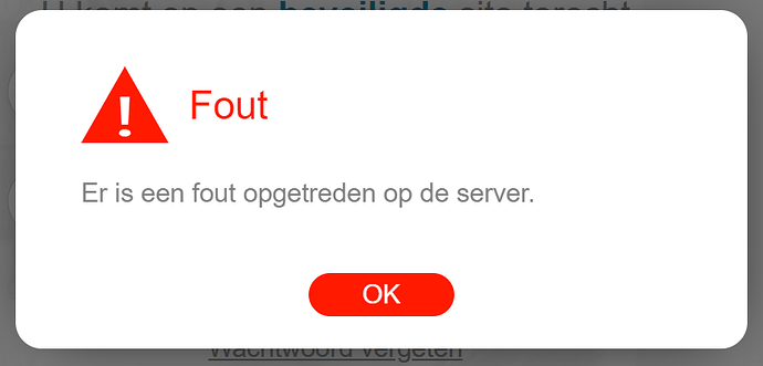

I experience issue’s in my Tahoma binding.
Also when I try to log in on tahomalink.com I receive an error so the problem is probably somfy related.
Does anyone else experience this issue?
