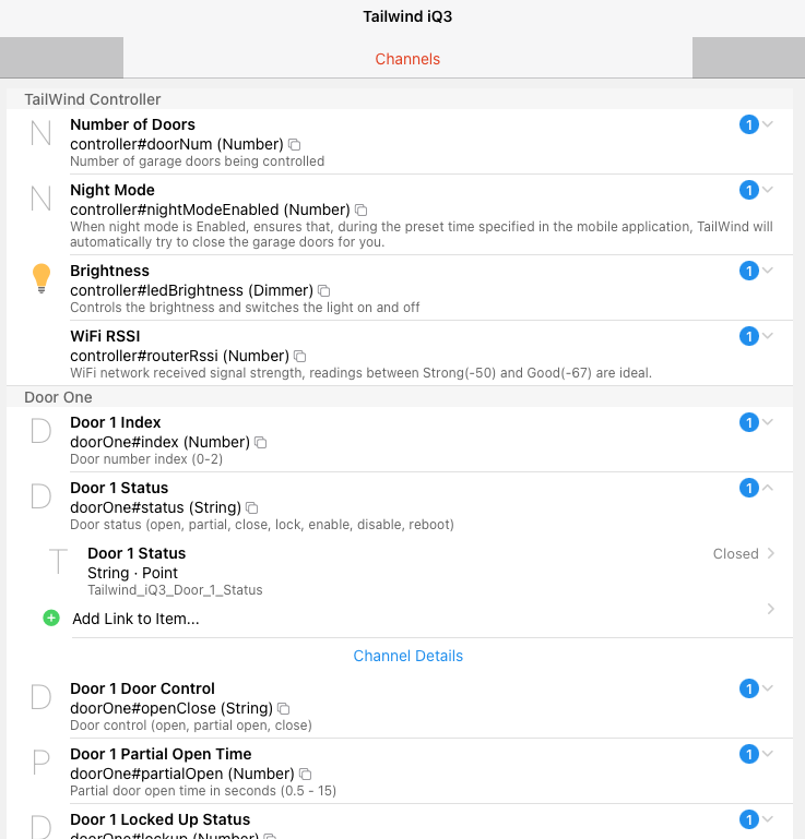

Wondering if my instructions for creating items may not be correct…
Couple things we could try.
  1. Completely remove the tailwind binding and any items that were configured for it. Then install the binding. Use Auto discover to find the controller, configure it.
  2. Turn on debug for the Tailwind binding.
  3. Then using the UI, create the door channel items your having issues with.
  4. Review the log to see more details about the binding.
