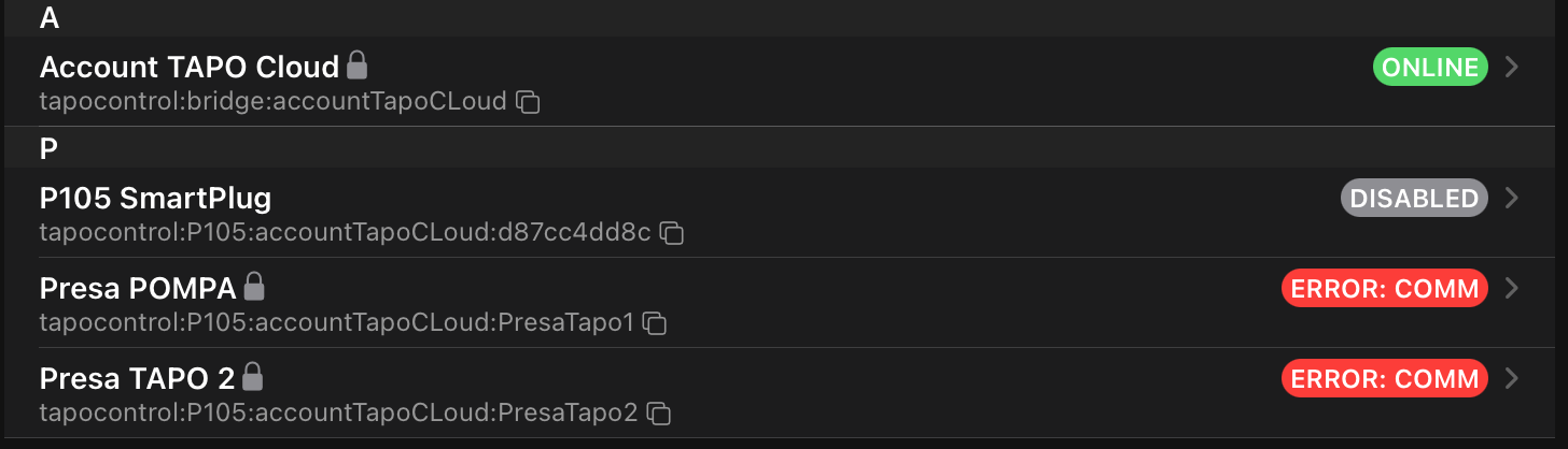

Also for me still have the error :
2023-12-05 21:46:59.230 [INFO ] [ab.event.ThingStatusInfoChangedEvent] - Thing 'tapocontrol:P105:accountTapoCLoud:PresaTapo1' changed from OFFLINE (COMMUNICATION_ERROR): login failed (1111) to UNKNOWN: login failed (1111)
thanks
My Tapo P115 smart plugs finally reported yesterday that there was a firmware update available. I updated them and then changed the connection to use the KLAP protocol (using the latest snapshot binding for OH 4.0.4). They worked right away!
So maybe you can try to remove the Tapo device in the app Tapo. And then add it again. Worked for me.

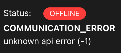

This error (api error -1) I got when I still had the market place addon installed. So could it be something went wrong installing the third party addon? I made mistake to save org.openhab.binding.tapocontrol-4.0.4-SNAPSHOT-sources.jar in the addon folder instead of org.openhab.binding.tapocontrol-4.0.4-SNAPSHOT.jar. After installing third party addon correctly I got error 1001 or handshake error. Then I removed the Tapo device in the Tapo app and added it again. Then in Openhab click disable and then enable the Tapo thing
