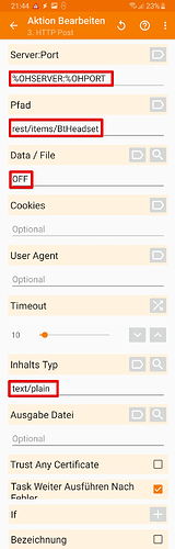

I just tied to create one of my “HTTP POST” actions as the new “HTTP Request” and it worked as posted by @rlkoshak
Here are the settings for the old and the new action.
My server name and port are stored in variables.
I did not need to define Accept: application/json.
old
new
