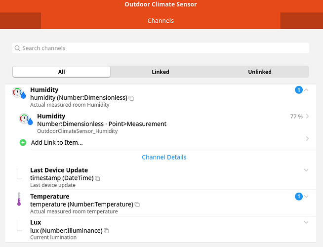

I have an issue with seeming all items connected to sensors. I have nexa sensors connected to my Tellstick Net v.1 bridge (with that bridge I’m forced to go through the cloud,Telldus Live) and verisure sensors, also through their cloud service.

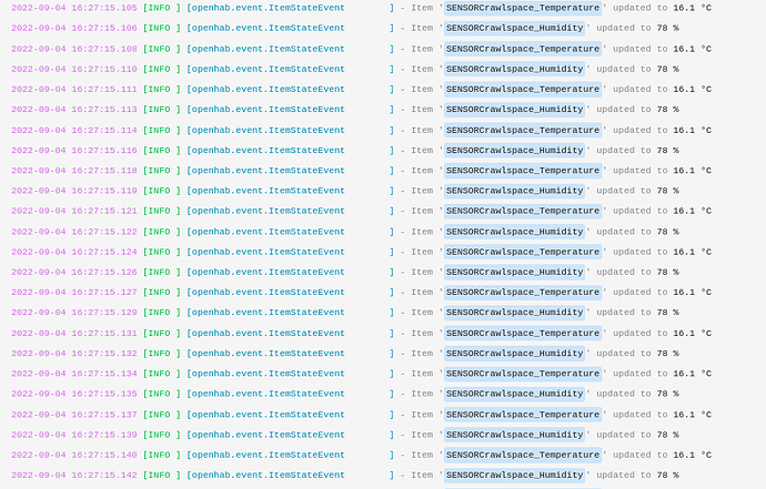

The problem is that every update sent from the sensor is duplicated tons of times, I’ve counted around 75. Here is an example of how it can look:
Since I save every update, it floods the database and makes charts slow. Does anyone know what’s going on here?

I’ve enabled TRACE logging for the binding, and this is what I see in openhab.log:

2022-09-12 19:17:33.583 [DEBUG] [ternal.handler.TelldusDevicesHandler] - Updating states of (SENSOR Crawl space (1540555924) id: tellstick:switch:5cb57369ab:8468702 or 8468702
2022-09-12 19:17:33.584 [DEBUG] [ternal.handler.TelldusDevicesHandler] - Updating states of (SENSOR Crawl space (1540555924) id: tellstick:sensor:5cb57369ab:1540384552 or 1540384552
2022-09-12 19:17:33.584 [DEBUG] [ternal.handler.TelldusDevicesHandler] - Updating states of (SENSOR Crawl space (1540555924) id: tellstick:switch:5cb57369ab:7969581 or 7969581
2022-09-12 19:17:33.585 [DEBUG] [ternal.handler.TelldusDevicesHandler] - Updating states of (SENSOR Crawl space (1540555924) id: tellstick:switch:5cb57369ab:7969581 or 7969581
2022-09-12 19:17:33.585 [DEBUG] [ternal.handler.TelldusDevicesHandler] - Updating states of (SENSOR Crawl space (1540555924) id: tellstick:switch:5cb57369ab:7969671 or 7969671
2022-09-12 19:17:33.586 [DEBUG] [ternal.handler.TelldusDevicesHandler] - Updating states of (SENSOR Crawl space (1540555924) id: tellstick:switch:5cb57369ab:9918526 or 9918526
2022-09-12 19:17:33.586 [DEBUG] [ternal.handler.TelldusDevicesHandler] - Updating states of (SENSOR Crawl space (1540555924) id: tellstick:switch:5cb57369ab:9945431 or 9945431
2022-09-12 19:17:33.587 [DEBUG] [ternal.handler.TelldusDevicesHandler] - Updating states of (SENSOR Crawl space (1540555924) id: tellstick:switch:5cb57369ab:9945431 or 9945431
2022-09-12 19:17:33.587 [DEBUG] [ternal.handler.TelldusDevicesHandler] - Updating states of (SENSOR Crawl space (1540555924) id: tellstick:switch:5cb57369ab:8597597 or 8597597
2022-09-12 19:17:33.588 [DEBUG] [ternal.handler.TelldusDevicesHandler] - Updating states of (SENSOR Crawl space (1540555924) id: tellstick:sensor:5cb57369ab:1540555924 or 1540555924
2022-09-12 19:17:33.589 [DEBUG] [ternal.handler.TelldusDevicesHandler] - Updating states of (SENSOR Crawl space (1540555924) id: tellstick:sensor:5cb57369ab:1540555924 or 1540555924
2022-09-12 19:17:33.590 [DEBUG] [ternal.handler.TelldusDevicesHandler] - Updating states of (SENSOR Crawl space (1540555924) id: tellstick:sensor:5cb57369ab:1540556014 or 1540556014
2022-09-12 19:17:33.591 [INFO ] [openhab.event.ItemStateEvent        ] - Item 'SENSORCrawlspace_Temperature' updated to 16.4 °C
2022-09-12 19:17:33.591 [DEBUG] [ternal.handler.TelldusDevicesHandler] - Updating states of (SENSOR Crawl space (1540555924) id: tellstick:sensor:5cb57369ab:1540556014 or 1540556014
2022-09-12 19:17:33.592 [DEBUG] [ternal.handler.TelldusDevicesHandler] - Updating states of (SENSOR Crawl space (1540555924) id: tellstick:switch:5cb57369ab:588090 or 588090
2022-09-12 19:17:33.593 [DEBUG] [ternal.handler.TelldusDevicesHandler] - Updating states of (SENSOR Crawl space (1540555924) id: tellstick:sensor:5cb57369ab:1540384552 or 1540384552
2022-09-12 19:17:33.593 [INFO ] [openhab.event.ItemStateEvent        ] - Item 'SENSORCrawlspace_Humidity' updated to 82 %
2022-09-12 19:17:33.594 [DEBUG] [ternal.handler.TelldusDevicesHandler] - Updating states of (SENSOR Crawl space (1540555924) id: tellstick:sensor:5cb57369ab:1540384552 or 1540384552
2022-09-12 19:17:33.594 [DEBUG] [ternal.handler.TelldusDevicesHandler] - Updating states of (SENSOR Crawl space (1540555924) id: tellstick:switch:5cb57369ab:7969671 or 7969671
2022-09-12 19:17:33.595 [DEBUG] [ternal.handler.TelldusDevicesHandler] - Updating states of (SENSOR Crawl space (1540555924) id: tellstick:switch:5cb57369ab:7969671 or 7969671
2022-09-12 19:17:33.596 [DEBUG] [ternal.handler.TelldusDevicesHandler] - Updating states of (SENSOR Crawl space (1540555924) id: tellstick:switch:5cb57369ab:9918526 or 9918526
2022-09-12 19:17:33.597 [DEBUG] [ternal.handler.TelldusDevicesHandler] - Updating states of (SENSOR Crawl space (1540555924) id: tellstick:switch:5cb57369ab:8468702 or 8468702
2022-09-12 19:17:33.597 [DEBUG] [ternal.handler.TelldusDevicesHandler] - Updating states of (SENSOR Crawl space (1540555924) id: tellstick:switch:5cb57369ab:7969581 or 7969581
2022-09-12 19:17:33.598 [DEBUG] [ternal.handler.TelldusDevicesHandler] - Updating states of (SENSOR Crawl space (1540555924) id: tellstick:switch:5cb57369ab:7969581 or 7969581
2022-09-12 19:17:33.598 [DEBUG] [ternal.handler.TelldusDevicesHandler] - Updating states of (SENSOR Crawl space (1540555924) id: tellstick:switch:5cb57369ab:9918531 or 9918531
2022-09-12 19:17:33.599 [DEBUG] [ternal.handler.TelldusDevicesHandler] - Updating states of (SENSOR Crawl space (1540555924) id: tellstick:switch:5cb57369ab:9918531 or 9918531
2022-09-12 19:17:33.599 [DEBUG] [ternal.handler.TelldusDevicesHandler] - Updating states of (SENSOR Crawl space (1540555924) id: tellstick:switch:5cb57369ab:9945431 or 9945431
2022-09-12 19:17:33.600 [DEBUG] [ternal.handler.TelldusDevicesHandler] - Updating states of (SENSOR Crawl space (1540555924) id: tellstick:switch:5cb57369ab:8597597 or 8597597
2022-09-12 19:17:33.601 [DEBUG] [ternal.handler.TelldusDevicesHandler] - Updating states of (SENSOR Crawl space (1540555924) id: tellstick:sensor:5cb57369ab:1540555924 or 1540555924
2022-09-12 19:17:33.602 [DEBUG] [ternal.handler.TelldusDevicesHandler] - Updating states of (SENSOR Crawl space (1540555924) id: tellstick:sensor:5cb57369ab:1540555924 or 1540555924
2022-09-12 19:17:33.603 [DEBUG] [ternal.handler.TelldusDevicesHandler] - Updating states of (SENSOR Crawl space (1540555924) id: tellstick:sensor:5cb57369ab:1540384552 or 1540384552
2022-09-12 19:17:33.604 [INFO ] [openhab.event.ItemStateEvent        ] - Item 'SENSORCrawlspace_Temperature' updated to 16.4 °C
2022-09-12 19:17:33.604 [DEBUG] [ternal.handler.TelldusDevicesHandler] - Updating states of (SENSOR Crawl space (1540555924) id: tellstick:sensor:5cb57369ab:1540384552 or 1540384552
2022-09-12 19:17:33.605 [DEBUG] [ternal.handler.TelldusDevicesHandler] - Updating states of (SENSOR Crawl space (1540555924) id: tellstick:switch:5cb57369ab:588090 or 588090
2022-09-12 19:17:33.606 [INFO ] [openhab.event.ItemStateEvent        ] - Item 'SENSORCrawlspace_Humidity' updated to 82 %
2022-09-12 19:17:33.606 [DEBUG] [ternal.handler.TelldusDevicesHandler] - Updating states of (SENSOR Crawl space (1540555924) id: tellstick:sensor:5cb57369ab:1540556014 or 1540556014
2022-09-12 19:17:33.607 [DEBUG] [ternal.handler.TelldusDevicesHandler] - Updating states of (SENSOR Crawl space (1540555924) id: tellstick:sensor:5cb57369ab:1540556014 or 1540556014
2022-09-12 19:17:33.608 [DEBUG] [ternal.handler.TelldusDevicesHandler] - Updating states of (SENSOR Crawl space (1540555924) id: tellstick:switch:5cb57369ab:7969671 or 7969671
2022-09-12 19:17:33.609 [DEBUG] [ternal.handler.TelldusDevicesHandler] - Updating states of (SENSOR Crawl space (1540555924) id: tellstick:switch:5cb57369ab:7969671 or 7969671
2022-09-12 19:17:33.609 [DEBUG] [ternal.handler.TelldusDevicesHandler] - Updating states of (SENSOR Crawl space (1540555924) id: tellstick:switch:5cb57369ab:9918526 or 9918526
2022-09-12 19:17:33.610 [DEBUG] [ternal.handler.TelldusDevicesHandler] - Updating states of (SENSOR Crawl space (1540555924) id: tellstick:switch:5cb57369ab:9918526 or 9918526
2022-09-12 19:17:33.610 [DEBUG] [ternal.handler.TelldusDevicesHandler] - Updating states of (SENSOR Crawl space (1540555924) id: tellstick:switch:5cb57369ab:8468702 or 8468702
2022-09-12 19:17:33.611 [DEBUG] [ternal.handler.TelldusDevicesHandler] - Updating states of (SENSOR Crawl space (1540555924) id: tellstick:switch:5cb57369ab:8468702 or 8468702
2022-09-12 19:17:33.611 [DEBUG] [ternal.handler.TelldusDevicesHandler] - Updating states of (SENSOR Crawl space (1540555924) id: tellstick:switch:5cb57369ab:7969581 or 7969581
2022-09-12 19:17:33.612 [DEBUG] [ternal.handler.TelldusDevicesHandler] - Updating states of (SENSOR Crawl space (1540555924) id: tellstick:switch:5cb57369ab:9918531 or 9918531
2022-09-12 19:17:33.612 [DEBUG] [ternal.handler.TelldusDevicesHandler] - Updating states of (SENSOR Crawl space (1540555924) id: tellstick:switch:5cb57369ab:8597597 or 8597597
2022-09-12 19:17:33.613 [DEBUG] [ternal.handler.TelldusDevicesHandler] - Updating states of (SENSOR Crawl space (1540555924) id: tellstick:switch:5cb57369ab:8597597 or 8597597
2022-09-12 19:17:33.613 [DEBUG] [ternal.handler.TelldusDevicesHandler] - Updating states of (SENSOR Crawl space (1540555924) id: tellstick:switch:5cb57369ab:9945431 or 9945431
2022-09-12 19:17:33.614 [DEBUG] [ternal.handler.TelldusDevicesHandler] - Updating states of (SENSOR Crawl space (1540555924) id: tellstick:switch:5cb57369ab:9945431 or 9945431
2022-09-12 19:17:33.614 [DEBUG] [ternal.handler.TelldusDevicesHandler] - Updating states of (SENSOR Crawl space (1540555924) id: tellstick:sensor:5cb57369ab:1540555924 or 1540555924
2022-09-12 19:17:33.615 [DEBUG] [ternal.handler.TelldusDevicesHandler] - Updating states of (SENSOR Crawl space (1540555924) id: tellstick:sensor:5cb57369ab:1540555924 or 1540555924
2022-09-12 19:17:33.617 [DEBUG] [ternal.handler.TelldusDevicesHandler] - Updating states of (SENSOR Crawl space (1540555924) id: tellstick:switch:5cb57369ab:588090 or 588090
2022-09-12 19:17:33.617 [INFO ] [openhab.event.ItemStateEvent        ] - Item 'SENSORCrawlspace_Temperature' updated to 16.4 °C
2022-09-12 19:17:33.618 [DEBUG] [ternal.handler.TelldusDevicesHandler] - Updating states of (SENSOR Crawl space (1540555924) id: tellstick:sensor:5cb57369ab:1540556014 or 1540556014
2022-09-12 19:17:33.619 [DEBUG] [ternal.handler.TelldusDevicesHandler] - Updating states of (SENSOR Crawl space (1540555924) id: tellstick:sensor:5cb57369ab:1540556014 or 1540556014
2022-09-12 19:17:33.620 [INFO ] [openhab.event.ItemStateEvent        ] - Item 'SENSORCrawlspace_Humidity' updated to 82 %
2022-09-12 19:17:33.620 [DEBUG] [ternal.handler.TelldusDevicesHandler] - Updating states of (SENSOR Crawl space (1540555924) id: tellstick:sensor:5cb57369ab:1540384552 or 1540384552
2022-09-12 19:17:33.621 [DEBUG] [ternal.handler.TelldusDevicesHandler] - Updating states of (SENSOR Crawl space (1540555924) id: tellstick:switch:5cb57369ab:9918526 or 9918526
2022-09-12 19:17:33.622 [DEBUG] [ternal.handler.TelldusDevicesHandler] - Updating states of (SENSOR Crawl space (1540555924) id: tellstick:switch:5cb57369ab:7969671 or 7969671
2022-09-12 19:17:33.623 [DEBUG] [ternal.handler.TelldusDevicesHandler] - Updating states of (SENSOR Crawl space (1540555924) id: tellstick:switch:5cb57369ab:8468702 or 8468702
2022-09-12 19:17:33.624 [DEBUG] [ternal.handler.TelldusDevicesHandler] - Updating states of (SENSOR Crawl space (1540555924) id: tellstick:switch:5cb57369ab:8597597 or 8597597
2022-09-12 19:17:33.624 [DEBUG] [ternal.handler.TelldusDevicesHandler] - Updating states of (SENSOR Crawl space (1540555924) id: tellstick:switch:5cb57369ab:9918531 or 9918531
2022-09-12 19:17:33.625 [DEBUG] [ternal.handler.TelldusDevicesHandler] - Updating states of (SENSOR Crawl space (1540555924) id: tellstick:switch:5cb57369ab:9918531 or 9918531
2022-09-12 19:17:33.625 [DEBUG] [ternal.handler.TelldusDevicesHandler] - Updating states of (SENSOR Crawl space (1540555924) id: tellstick:switch:5cb57369ab:9945431 or 9945431
2022-09-12 19:17:33.626 [DEBUG] [ternal.handler.TelldusDevicesHandler] - Updating states of (SENSOR Crawl space (1540555924) id: tellstick:switch:5cb57369ab:9945431 or 9945431
2022-09-12 19:17:33.626 [DEBUG] [ternal.handler.TelldusDevicesHandler] - Updating states of (SENSOR Crawl space (1540555924) id: tellstick:switch:5cb57369ab:7969581 or 7969581
2022-09-12 19:17:33.627 [DEBUG] [ternal.handler.TelldusDevicesHandler] - Updating states of (SENSOR Crawl space (1540555924) id: tellstick:switch:5cb57369ab:7969581 or 7969581
2022-09-12 19:17:33.627 [DEBUG] [ternal.handler.TelldusDevicesHandler] - Updating states of (SENSOR Crawl space (1540555924) id: tellstick:sensor:5cb57369ab:1540555924 or 1540555924
2022-09-12 19:17:33.628 [DEBUG] [ternal.handler.TelldusDevicesHandler] - Updating states of (SENSOR Crawl space (1540555924) id: tellstick:sensor:5cb57369ab:1540555924 or 1540555924
2022-09-12 19:17:33.630 [INFO ] [openhab.event.ItemStateEvent        ] - Item 'SENSORCrawlspace_Temperature' updated to 16.4 °C
2022-09-12 19:17:33.630 [DEBUG] [ternal.handler.TelldusDevicesHandler] - Updating states of (SENSOR Crawl space (1540555924) id: tellstick:sensor:5cb57369ab:1540556014 or 1540556014
2022-09-12 19:17:33.631 [DEBUG] [ternal.handler.TelldusDevicesHandler] - Updating states of (SENSOR Crawl space (1540555924) id: tellstick:sensor:5cb57369ab:1540556014 or 1540556014
2022-09-12 19:17:33.631 [DEBUG] [ternal.handler.TelldusDevicesHandler] - Updating states of (SENSOR Crawl space (1540555924) id: tellstick:switch:5cb57369ab:588090 or 588090
2022-09-12 19:17:33.632 [DEBUG] [ternal.handler.TelldusDevicesHandler] - Updating states of (SENSOR Crawl space (1540555924) id: tellstick:switch:5cb57369ab:588090 or 588090
2022-09-12 19:17:33.633 [INFO ] [openhab.event.ItemStateEvent        ] - Item 'SENSORCrawlspace_Humidity' updated to 82 %
2022-09-12 19:17:33.633 [DEBUG] [ternal.handler.TelldusDevicesHandler] - Updating states of (SENSOR Crawl space (1540555924) id: tellstick:switch:5cb57369ab:9918526 or 9918526
2022-09-12 19:17:33.634 [DEBUG] [ternal.handler.TelldusDevicesHandler] - Updating states of (SENSOR Crawl space (1540555924) id: tellstick:switch:5cb57369ab:9918526 or 9918526
2022-09-12 19:17:33.634 [DEBUG] [ternal.handler.TelldusDevicesHandler] - Updating states of (SENSOR Crawl space (1540555924) id: tellstick:sensor:5cb57369ab:1540384552 or 1540384552
2022-09-12 19:17:33.635 [DEBUG] [ternal.handler.TelldusDevicesHandler] - Updating states of (SENSOR Crawl space (1540555924) id: tellstick:sensor:5cb57369ab:1540384552 or 1540384552
2022-09-12 19:17:33.635 [DEBUG] [ternal.handler.TelldusDevicesHandler] - Updating states of (SENSOR Crawl space (1540555924) id: tellstick:switch:5cb57369ab:7969671 or 7969671
2022-09-12 19:17:33.636 [DEBUG] [ternal.handler.TelldusDevicesHandler] - Updating states of (SENSOR Crawl space (1540555924) id: tellstick:switch:5cb57369ab:8597597 or 8597597
2022-09-12 19:17:33.637 [DEBUG] [ternal.handler.TelldusDevicesHandler] - Updating states of (SENSOR Crawl space (1540555924) id: tellstick:switch:5cb57369ab:9945431 or 9945431
2022-09-12 19:17:33.638 [DEBUG] [ternal.handler.TelldusDevicesHandler] - Updating states of (SENSOR Crawl space (1540555924) id: tellstick:switch:5cb57369ab:9918531 or 9918531
2022-09-12 19:17:33.638 [DEBUG] [ternal.handler.TelldusDevicesHandler] - Updating states of (SENSOR Crawl space (1540555924) id: tellstick:switch:5cb57369ab:7969581 or 7969581
2022-09-12 19:17:33.639 [DEBUG] [ternal.handler.TelldusDevicesHandler] - Updating states of (SENSOR Crawl space (1540555924) id: tellstick:switch:5cb57369ab:7969581 or 7969581
2022-09-12 19:17:33.639 [DEBUG] [ternal.handler.TelldusDevicesHandler] - Updating states of (SENSOR Crawl space (1540555924) id: tellstick:switch:5cb57369ab:8468702 or 8468702
2022-09-12 19:17:33.640 [DEBUG] [ternal.handler.TelldusDevicesHandler] - Updating states of (SENSOR Crawl space (1540555924) id: tellstick:switch:5cb57369ab:588090 or 588090
2022-09-12 19:17:33.640 [DEBUG] [ternal.handler.TelldusDevicesHandler] - Updating states of (SENSOR Crawl space (1540555924) id: tellstick:sensor:5cb57369ab:1540555924 or 1540555924
2022-09-12 19:17:33.642 [DEBUG] [ternal.handler.TelldusDevicesHandler] - Updating states of (SENSOR Crawl space (1540555924) id: tellstick:sensor:5cb57369ab:1540555924 or 1540555924
2022-09-12 19:17:33.643 [INFO ] [openhab.event.ItemStateEvent        ] - Item 'SENSORCrawlspace_Temperature' updated to 16.4 °C
2022-09-12 19:17:33.643 [DEBUG] [ternal.handler.TelldusDevicesHandler] - Updating states of (SENSOR Crawl space (1540555924) id: tellstick:switch:5cb57369ab:9918526 or 9918526
2022-09-12 19:17:33.644 [DEBUG] [ternal.handler.TelldusDevicesHandler] - Updating states of (SENSOR Crawl space (1540555924) id: tellstick:switch:5cb57369ab:9918526 or 9918526
2022-09-12 19:17:33.644 [DEBUG] [ternal.handler.TelldusDevicesHandler] - Updating states of (SENSOR Crawl space (1540555924) id: tellstick:sensor:5cb57369ab:1540556014 or 1540556014
2022-09-12 19:17:33.645 [DEBUG] [ternal.handler.TelldusDevicesHandler] - Updating states of (SENSOR Crawl space (1540555924) id: tellstick:sensor:5cb57369ab:1540556014 or 1540556014
2022-09-12 19:17:33.646 [INFO ] [openhab.event.ItemStateEvent        ] - Item 'SENSORCrawlspace_Humidity' updated to 82 %
2022-09-12 19:17:33.646 [DEBUG] [ternal.handler.TelldusDevicesHandler] - Updating states of (SENSOR Crawl space (1540555924) id: tellstick:sensor:5cb57369ab:1540384552 or 1540384552
2022-09-12 19:17:33.647 [DEBUG] [ternal.handler.TelldusDevicesHandler] - Updating states of (SENSOR Crawl space (1540555924) id: tellstick:switch:5cb57369ab:8468702 or 8468702
2022-09-12 19:17:33.648 [DEBUG] [ternal.handler.TelldusDevicesHandler] - Updating states of (SENSOR Crawl space (1540555924) id: tellstick:switch:5cb57369ab:7969671 or 7969671
2022-09-12 19:17:33.648 [DEBUG] [ternal.handler.TelldusDevicesHandler] - Updating states of (SENSOR Crawl space (1540555924) id: tellstick:switch:5cb57369ab:8597597 or 8597597
2022-09-12 19:17:33.649 [DEBUG] [ternal.handler.TelldusDevicesHandler] - Updating states of (SENSOR Crawl space (1540555924) id: tellstick:switch:5cb57369ab:8597597 or 8597597
2022-09-12 19:17:33.649 [DEBUG] [ternal.handler.TelldusDevicesHandler] - Updating states of (SENSOR Crawl space (1540555924) id: tellstick:switch:5cb57369ab:9945431 or 9945431
2022-09-12 19:17:33.650 [DEBUG] [ternal.handler.TelldusDevicesHandler] - Updating states of (SENSOR Crawl space (1540555924) id: tellstick:switch:5cb57369ab:9918531 or 9918531
2022-09-12 19:17:33.650 [DEBUG] [ternal.handler.TelldusDevicesHandler] - Updating states of (SENSOR Crawl space (1540555924) id: tellstick:switch:5cb57369ab:7969581 or 7969581
2022-09-12 19:17:33.651 [DEBUG] [ternal.handler.TelldusDevicesHandler] - Updating states of (SENSOR Crawl space (1540555924) id: tellstick:switch:5cb57369ab:7969581 or 7969581
2022-09-12 19:17:33.651 [DEBUG] [ternal.handler.TelldusDevicesHandler] - Updating states of (SENSOR Crawl space (1540555924) id: tellstick:switch:5cb57369ab:588090 or 588090
2022-09-12 19:17:33.652 [DEBUG] [ternal.handler.TelldusDevicesHandler] - Updating states of (SENSOR Crawl space (1540555924) id: tellstick:sensor:5cb57369ab:1540555924 or 1540555924
2022-09-12 19:17:33.653 [DEBUG] [ternal.handler.TelldusDevicesHandler] - Updating states of (SENSOR Crawl space (1540555924) id: tellstick:sensor:5cb57369ab:1540555924 or 1540555924
2022-09-12 19:17:33.655 [INFO ] [openhab.event.ItemStateEvent        ] - Item 'SENSORCrawlspace_Temperature' updated to 16.4 °C
2022-09-12 19:17:33.655 [DEBUG] [ternal.handler.TelldusDevicesHandler] - Updating states of (SENSOR Crawl space (1540555924) id: tellstick:sensor:5cb57369ab:1540556014 or 1540556014
2022-09-12 19:17:33.656 [DEBUG] [ternal.handler.TelldusDevicesHandler] - Updating states of (SENSOR Crawl space (1540555924) id: tellstick:switch:5cb57369ab:9918526 or 9918526
2022-09-12 19:17:33.657 [INFO ] [openhab.event.ItemStateEvent        ] - Item 'SENSORCrawlspace_Humidity' updated to 82 %
2022-09-12 19:17:33.657 [DEBUG] [ternal.handler.TelldusDevicesHandler] - Updating states of (SENSOR Crawl space (1540555924) id: tellstick:sensor:5cb57369ab:1540384552 or 1540384552
2022-09-12 19:17:33.658 [DEBUG] [ternal.handler.TelldusDevicesHandler] - Updating states of (SENSOR Crawl space (1540555924) id: tellstick:sensor:5cb57369ab:1540384552 or 1540384552
2022-09-12 19:17:33.658 [DEBUG] [ternal.handler.TelldusDevicesHandler] - Updating states of (SENSOR Crawl space (1540555924) id: tellstick:switch:5cb57369ab:8468702 or 8468702
2022-09-12 19:17:33.659 [DEBUG] [ternal.handler.TelldusDevicesHandler] - Updating states of (SENSOR Crawl space (1540555924) id: tellstick:switch:5cb57369ab:9918531 or 9918531
2022-09-12 19:17:33.660 [DEBUG] [ternal.handler.TelldusDevicesHandler] - Updating states of (SENSOR Crawl space (1540555924) id: tellstick:switch:5cb57369ab:7969581 or 7969581
2022-09-12 19:17:33.660 [DEBUG] [ternal.handler.TelldusDevicesHandler] - Updating states of (SENSOR Crawl space (1540555924) id: tellstick:switch:5cb57369ab:9945431 or 9945431
2022-09-12 19:17:33.661 [DEBUG] [ternal.handler.TelldusDevicesHandler] - Updating states of (SENSOR Crawl space (1540555924) id: tellstick:switch:5cb57369ab:9945431 or 9945431
2022-09-12 19:17:33.661 [DEBUG] [ternal.handler.TelldusDevicesHandler] - Updating states of (SENSOR Crawl space (1540555924) id: tellstick:switch:5cb57369ab:8597597 or 8597597
2022-09-12 19:17:33.662 [DEBUG] [ternal.handler.TelldusDevicesHandler] - Updating states of (SENSOR Crawl space (1540555924) id: tellstick:switch:5cb57369ab:7969671 or 7969671
2022-09-12 19:17:33.662 [DEBUG] [ternal.handler.TelldusDevicesHandler] - Updating states of (SENSOR Crawl space (1540555924) id: tellstick:switch:5cb57369ab:9918526 or 9918526
2022-09-12 19:17:33.663 [DEBUG] [ternal.handler.TelldusDevicesHandler] - Updating states of (SENSOR Crawl space (1540555924) id: tellstick:switch:5cb57369ab:9918526 or 9918526
2022-09-12 19:17:33.663 [DEBUG] [ternal.handler.TelldusDevicesHandler] - Updating states of (SENSOR Crawl space (1540555924) id: tellstick:sensor:5cb57369ab:1540384552 or 1540384552
2022-09-12 19:17:33.664 [DEBUG] [ternal.handler.TelldusDevicesHandler] - Updating states of (SENSOR Crawl space (1540555924) id: tellstick:sensor:5cb57369ab:1540384552 or 1540384552
2022-09-12 19:17:33.664 [DEBUG] [ternal.handler.TelldusDevicesHandler] - Updating states of (SENSOR Crawl space (1540555924) id: tellstick:switch:5cb57369ab:588090 or 588090
2022-09-12 19:17:33.665 [DEBUG] [ternal.handler.TelldusDevicesHandler] - Updating states of (SENSOR Crawl space (1540555924) id: tellstick:sensor:5cb57369ab:1540555924 or 1540555924
2022-09-12 19:17:33.666 [DEBUG] [ternal.handler.TelldusDevicesHandler] - Updating states of (SENSOR Crawl space (1540555924) id: tellstick:sensor:5cb57369ab:1540555924 or 1540555924
2022-09-12 19:17:33.667 [INFO ] [openhab.event.ItemStateEvent        ] - Item 'SENSORCrawlspace_Temperature' updated to 16.4 °C
2022-09-12 19:17:33.667 [DEBUG] [ternal.handler.TelldusDevicesHandler] - Updating states of (SENSOR Crawl space (1540555924) id: tellstick:sensor:5cb57369ab:1540556014 or 1540556014
2022-09-12 19:17:33.668 [DEBUG] [ternal.handler.TelldusDevicesHandler] - Updating states of (SENSOR Crawl space (1540555924) id: tellstick:sensor:5cb57369ab:1540556014 or 1540556014
2022-09-12 19:17:33.668 [DEBUG] [ternal.handler.TelldusDevicesHandler] - Updating states of (SENSOR Crawl space (1540555924) id: tellstick:switch:5cb57369ab:9918531 or 9918531
2022-09-12 19:17:33.669 [DEBUG] [ternal.handler.TelldusDevicesHandler] - Updating states of (SENSOR Crawl space (1540555924) id: tellstick:switch:5cb57369ab:9918531 or 9918531
2022-09-12 19:17:33.670 [INFO ] [openhab.event.ItemStateEvent        ] - Item 'SENSORCrawlspace_Humidity' updated to 82 %
2022-09-12 19:17:33.670 [DEBUG] [ternal.handler.TelldusDevicesHandler] - Updating states of (SENSOR Crawl space (1540555924) id: tellstick:switch:5cb57369ab:7969581 or 7969581
2022-09-12 19:17:33.671 [DEBUG] [ternal.handler.TelldusDevicesHandler] - Updating states of (SENSOR Crawl space (1540555924) id: tellstick:switch:5cb57369ab:8597597 or 8597597
2022-09-12 19:17:33.671 [DEBUG] [ternal.handler.TelldusDevicesHandler] - Updating states of (SENSOR Crawl space (1540555924) id: tellstick:switch:5cb57369ab:8468702 or 8468702
2022-09-12 19:17:33.672 [DEBUG] [ternal.handler.TelldusDevicesHandler] - Updating states of (SENSOR Crawl space (1540555924) id: tellstick:switch:5cb57369ab:8468702 or 8468702
2022-09-12 19:17:33.672 [DEBUG] [ternal.handler.TelldusDevicesHandler] - Updating states of (SENSOR Crawl space (1540555924) id: tellstick:switch:5cb57369ab:9945431 or 9945431
2022-09-12 19:17:33.673 [DEBUG] [ternal.handler.TelldusDevicesHandler] - Updating states of (SENSOR Crawl space (1540555924) id: tellstick:switch:5cb57369ab:9945431 or 9945431
2022-09-12 19:17:33.673 [DEBUG] [ternal.handler.TelldusDevicesHandler] - Updating states of (SENSOR Crawl space (1540555924) id: tellstick:switch:5cb57369ab:7969671 or 7969671
2022-09-12 19:17:33.674 [DEBUG] [ternal.handler.TelldusDevicesHandler] - Updating states of (SENSOR Crawl space (1540555924) id: tellstick:switch:5cb57369ab:9918526 or 9918526
2022-09-12 19:17:33.674 [DEBUG] [ternal.handler.TelldusDevicesHandler] - Updating states of (SENSOR Crawl space (1540555924) id: tellstick:switch:5cb57369ab:588090 or 588090
2022-09-12 19:17:33.675 [DEBUG] [ternal.handler.TelldusDevicesHandler] - Updating states of (SENSOR Crawl space (1540555924) id: tellstick:switch:5cb57369ab:588090 or 588090
2022-09-12 19:17:33.675 [DEBUG] [ternal.handler.TelldusDevicesHandler] - Updating states of (SENSOR Crawl space (1540555924) id: tellstick:sensor:5cb57369ab:1540556014 or 1540556014
2022-09-12 19:17:33.676 [DEBUG] [ternal.handler.TelldusDevicesHandler] - Updating states of (SENSOR Crawl space (1540555924) id: tellstick:switch:5cb57369ab:9918531 or 9918531
2022-09-12 19:17:33.676 [DEBUG] [ternal.handler.TelldusDevicesHandler] - Updating states of (SENSOR Crawl space (1540555924) id: tellstick:sensor:5cb57369ab:1540384552 or 1540384552
2022-09-12 19:17:33.677 [DEBUG] [ternal.handler.TelldusDevicesHandler] - Updating states of (SENSOR Crawl space (1540555924) id: tellstick:sensor:5cb57369ab:1540384552 or 1540384552
2022-09-12 19:17:33.677 [DEBUG] [ternal.handler.TelldusDevicesHandler] - Updating states of (SENSOR Crawl space (1540555924) id: tellstick:switch:5cb57369ab:8597597 or 8597597
2022-09-12 19:17:33.678 [DEBUG] [ternal.handler.TelldusDevicesHandler] - Updating states of (SENSOR Crawl space (1540555924) id: tellstick:switch:5cb57369ab:7969581 or 7969581
2022-09-12 19:17:33.679 [DEBUG] [ternal.handler.TelldusDevicesHandler] - Updating states of (SENSOR Crawl space (1540555924) id: tellstick:switch:5cb57369ab:7969671 or 7969671
2022-09-12 19:17:33.679 [DEBUG] [ternal.handler.TelldusDevicesHandler] - Updating states of (SENSOR Crawl space (1540555924) id: tellstick:switch:5cb57369ab:9945431 or 9945431
2022-09-12 19:17:33.680 [DEBUG] [ternal.handler.TelldusDevicesHandler] - Updating states of (SENSOR Crawl space (1540555924) id: tellstick:switch:5cb57369ab:9945431 or 9945431
2022-09-12 19:17:33.680 [DEBUG] [ternal.handler.TelldusDevicesHandler] - Updating states of (SENSOR Crawl space (1540555924) id: tellstick:switch:5cb57369ab:8468702 or 8468702
2022-09-12 19:17:33.681 [DEBUG] [ternal.handler.TelldusDevicesHandler] - Updating states of (SENSOR Crawl space (1540555924) id: tellstick:sensor:5cb57369ab:1540555924 or 1540555924
2022-09-12 19:17:33.682 [DEBUG] [ternal.handler.TelldusDevicesHandler] - Updating states of (SENSOR Crawl space (1540555924) id: tellstick:sensor:5cb57369ab:1540555924 or 1540555924
2022-09-12 19:17:33.683 [INFO ] [openhab.event.ItemStateEvent        ] - Item 'SENSORCrawlspace_Temperature' updated to 16.4 °C
2022-09-12 19:17:33.683 [DEBUG] [ternal.handler.TelldusDevicesHandler] - Updating states of (SENSOR Crawl space (1540555924) id: tellstick:switch:5cb57369ab:588090 or 588090
2022-09-12 19:17:33.684 [DEBUG] [ternal.handler.TelldusDevicesHandler] - Updating states of (SENSOR Crawl space (1540555924) id: tellstick:switch:5cb57369ab:588090 or 588090
2022-09-12 19:17:33.684 [DEBUG] [ternal.handler.TelldusDevicesHandler] - Updating states of (SENSOR Crawl space (1540555924) id: tellstick:sensor:5cb57369ab:1540556014 or 1540556014
2022-09-12 19:17:33.685 [DEBUG] [ternal.handler.TelldusDevicesHandler] - Updating states of (SENSOR Crawl space (1540555924) id: tellstick:sensor:5cb57369ab:1540556014 or 1540556014
2022-09-12 19:17:33.686 [INFO ] [openhab.event.ItemStateEvent        ] - Item 'SENSORCrawlspace_Humidity' updated to 82 %
2022-09-12 19:17:33.686 [DEBUG] [ternal.handler.TelldusDevicesHandler] - Updating states of (SENSOR Crawl space (1540555924) id: tellstick:sensor:5cb57369ab:1540384552 or 1540384552
2022-09-12 19:17:33.687 [DEBUG] [ternal.handler.TelldusDevicesHandler] - Updating states of (SENSOR Crawl space (1540555924) id: tellstick:switch:5cb57369ab:9918531 or 9918531
2022-09-12 19:17:33.688 [DEBUG] [ternal.handler.TelldusDevicesHandler] - Updating states of (SENSOR Crawl space (1540555924) id: tellstick:switch:5cb57369ab:9918526 or 9918526
2022-09-12 19:17:33.688 [DEBUG] [ternal.handler.TelldusDevicesHandler] - Updating states of (SENSOR Crawl space (1540555924) id: tellstick:switch:5cb57369ab:8597597 or 8597597
2022-09-12 19:17:33.689 [DEBUG] [ternal.handler.TelldusDevicesHandler] - Updating states of (SENSOR Crawl space (1540555924) id: tellstick:switch:5cb57369ab:8597597 or 8597597
2022-09-12 19:17:33.689 [DEBUG] [ternal.handler.TelldusDevicesHandler] - Updating states of (SENSOR Crawl space (1540555924) id: tellstick:switch:5cb57369ab:7969581 or 7969581
2022-09-12 19:17:33.690 [DEBUG] [ternal.handler.TelldusDevicesHandler] - Updating states of (SENSOR Crawl space (1540555924) id: tellstick:sensor:5cb57369ab:1540555924 or 1540555924
2022-09-12 19:17:33.691 [DEBUG] [ternal.handler.TelldusDevicesHandler] - Updating states of (SENSOR Crawl space (1540555924) id: tellstick:sensor:5cb57369ab:1540555924 or 1540555924
2022-09-12 19:17:33.692 [DEBUG] [ternal.handler.TelldusDevicesHandler] - Updating states of (SENSOR Crawl space (1540555924) id: tellstick:switch:5cb57369ab:7969671 or 7969671
2022-09-12 19:17:33.692 [INFO ] [openhab.event.ItemStateEvent        ] - Item 'SENSORCrawlspace_Temperature' updated to 16.4 °C
2022-09-12 19:17:33.693 [DEBUG] [ternal.handler.TelldusDevicesHandler] - Updating states of (SENSOR Crawl space (1540555924) id: tellstick:switch:5cb57369ab:7969671 or 7969671
2022-09-12 19:17:33.693 [DEBUG] [ternal.handler.TelldusDevicesHandler] - Updating states of (SENSOR Crawl space (1540555924) id: tellstick:switch:5cb57369ab:8468702 or 8468702
2022-09-12 19:17:33.694 [DEBUG] [ternal.handler.TelldusDevicesHandler] - Updating states of (SENSOR Crawl space (1540555924) id: tellstick:switch:5cb57369ab:8468702 or 8468702
2022-09-12 19:17:33.695 [INFO ] [openhab.event.ItemStateEvent        ] - Item 'SENSORCrawlspace_Humidity' updated to 82 %
2022-09-12 19:17:33.695 [DEBUG] [ternal.handler.TelldusDevicesHandler] - Updating states of (SENSOR Crawl space (1540555924) id: tellstick:switch:5cb57369ab:9945431 or 9945431
2022-09-12 19:17:33.696 [DEBUG] [ternal.handler.TelldusDevicesHandler] - Updating states of (SENSOR Crawl space (1540555924) id: tellstick:sensor:5cb57369ab:1540556014 or 1540556014
2022-09-12 19:17:33.696 [DEBUG] [ternal.handler.TelldusDevicesHandler] - Updating states of (SENSOR Crawl space (1540555924) id: tellstick:switch:5cb57369ab:588090 or 588090
2022-09-12 19:17:33.697 [DEBUG] [ternal.handler.TelldusDevicesHandler] - Updating states of (SENSOR Crawl space (1540555924) id: tellstick:switch:5cb57369ab:588090 or 588090
2022-09-12 19:17:33.697 [DEBUG] [ternal.handler.TelldusDevicesHandler] - Updating states of (SENSOR Crawl space (1540555924) id: tellstick:switch:5cb57369ab:9918526 or 9918526
2022-09-12 19:17:33.698 [DEBUG] [ternal.handler.TelldusDevicesHandler] - Updating states of (SENSOR Crawl space (1540555924) id: tellstick:switch:5cb57369ab:9918526 or 9918526
2022-09-12 19:17:33.698 [DEBUG] [ternal.handler.TelldusDevicesHandler] - Updating states of (SENSOR Crawl space (1540555924) id: tellstick:sensor:5cb57369ab:1540384552 or 1540384552
2022-09-12 19:17:33.699 [DEBUG] [ternal.handler.TelldusDevicesHandler] - Updating states of (SENSOR Crawl space (1540555924) id: tellstick:switch:5cb57369ab:7969671 or 7969671
2022-09-12 19:17:33.699 [DEBUG] [ternal.handler.TelldusDevicesHandler] - Updating states of (SENSOR Crawl space (1540555924) id: tellstick:switch:5cb57369ab:9918531 or 9918531
2022-09-12 19:17:33.700 [DEBUG] [ternal.handler.TelldusDevicesHandler] - Updating states of (SENSOR Crawl space (1540555924) id: tellstick:switch:5cb57369ab:9918531 or 9918531
2022-09-12 19:17:33.700 [DEBUG] [ternal.handler.TelldusDevicesHandler] - Updating states of (SENSOR Crawl space (1540555924) id: tellstick:switch:5cb57369ab:7969581 or 7969581
2022-09-12 19:17:33.701 [DEBUG] [ternal.handler.TelldusDevicesHandler] - Updating states of (SENSOR Crawl space (1540555924) id: tellstick:switch:5cb57369ab:8468702 or 8468702
2022-09-12 19:17:33.701 [DEBUG] [ternal.handler.TelldusDevicesHandler] - Updating states of (SENSOR Crawl space (1540555924) id: tellstick:sensor:5cb57369ab:1540555924 or 1540555924
2022-09-12 19:17:33.703 [DEBUG] [ternal.handler.TelldusDevicesHandler] - Updating states of (SENSOR Crawl space (1540555924) id: tellstick:sensor:5cb57369ab:1540555924 or 1540555924
2022-09-12 19:17:33.704 [INFO ] [openhab.event.ItemStateEvent        ] - Item 'SENSORCrawlspace_Temperature' updated to 16.4 °C
2022-09-12 19:17:33.704 [DEBUG] [ternal.handler.TelldusDevicesHandler] - Updating states of (SENSOR Crawl space (1540555924) id: tellstick:switch:5cb57369ab:9945431 or 9945431
2022-09-12 19:17:33.705 [DEBUG] [ternal.handler.TelldusDevicesHandler] - Updating states of (SENSOR Crawl space (1540555924) id: tellstick:switch:5cb57369ab:9945431 or 9945431
2022-09-12 19:17:33.705 [DEBUG] [ternal.handler.TelldusDevicesHandler] - Updating states of (SENSOR Crawl space (1540555924) id: tellstick:switch:5cb57369ab:8597597 or 8597597
2022-09-12 19:17:33.706 [DEBUG] [ternal.handler.TelldusDevicesHandler] - Updating states of (SENSOR Crawl space (1540555924) id: tellstick:switch:5cb57369ab:8597597 or 8597597
2022-09-12 19:17:33.707 [INFO ] [openhab.event.ItemStateEvent        ] - Item 'SENSORCrawlspace_Humidity' updated to 82 %
2022-09-12 19:17:36.846 [TRACE] [nal.live.TelldusLiveDeviceController] - Request [http://api.telldus.com/xml/devices/list?supportedMethods=19] Response:<?xml version="1.0" encoding="utf-8" ?>
<devices>
	<device id="9945431" clientDeviceId="14" name="Carport Inner Lights" state="2" statevalue="" methods="3" metadataHash="" parametersHash="7c36bf492221e43b2065609d9b46fe7dd402eae8" type="device" client="126139" clientName="Stanstorp" online="1" editable="1" ignored="0" />
	<device id="10666457" clientDeviceId="15" name="Dusk Sensor" state="1" statevalue="" methods="3" metadataHash="" parametersHash="f5b96d8776b5945bc86e355d54bc1fab278fcdca" type="device" client="126139" clientName="Stanstorp" online="1" editable="1" ignored="0" />
	<device id="8597597" clientDeviceId="11" name="D&#246;rrklocka" state="2" statevalue="" methods="3" metadataHash="" parametersHash="18ad0b3f18aa1c4d9a24045e4c322f047b1d555f" type="device" client="126139" clientName="Stanstorp" online="1" editable="1" ignored="0" />
	<device id="7969581" clientDeviceId="6" name="Ek/V&#228;g-lampa" state="2" statevalue="" methods="3" metadataHash="" parametersHash="00c8346f30f4a05cba3c6bb783201d2d3b81cd0f" type="device" client="126139" clientName="Stanstorp" online="1" editable="1" ignored="0" />
	<device id="588090" clientDeviceId="2" name="Element h&#246;ger" state="2" statevalue="unde" methods="3" metadataHash="" parametersHash="673f0bf447780556fba79c0d476c11ac2eb12812" type="device" client="126139" clientName="Stanstorp" online="1" editable="1" ignored="0" />
	<device id="8468702" clientDeviceId="8" name="Element v&#228;nster" state="2" statevalue="" methods="3" metadataHash="" parametersHash="bafbd01080b4c074b19e0ff6974dc4e1eb49a460" type="device" client="126139" clientName="Stanstorp" online="1" editable="1" ignored="0" />
	<device id="9918531" clientDeviceId="13" name="Framd&#246;rr lampa" state="2" statevalue="" methods="3" metadataHash="" parametersHash="9d06f3925130649b157c489c14077eea7f33932e" type="device" client="126139" clientName="Stanstorp" online="1" editable="1" ignored="0" />
	<device id="9918526" clientDeviceId="12" name="K&#228;llarlampa" state="2" statevalue="" methods="3" metadataHash="" parametersHash="1828f54a12ce36b352f8202e3b7f12c507ec9b63" type="device" client="126139" clientName="Stanstorp" online="1" editable="1" ignored="0" />
	<device id="7969671" clientDeviceId="7" name="Lyktstolpe" state="2" statevalue="" methods="3" metadataHash="" parametersHash="bf7ea38193dd79b833ac27ac1f87216d4b5d4a8c" type="device" client="126139" clientName="Stanstorp" online="1" editable="1" ignored="0" />
</devices>
2022-09-12 19:17:36.847 [DEBUG] [ternal.live.TelldusLiveBridgeHandler] - Device list [TellstickNetDevice [deviceId=9945431, name=Carport Inner Lights, online=true, state=2, statevalue=, updated=false], TellstickNetDevice [deviceId=10666457, name=Dusk Sensor, online=true, state=1, statevalue=, updated=false], TellstickNetDevice [deviceId=8597597, name=Dörrklocka, online=true, state=2, statevalue=, updated=false], TellstickNetDevice [deviceId=7969581, name=Ek/Väg-lampa, online=true, state=2, statevalue=, updated=false], TellstickNetDevice [deviceId=588090, name=Element höger, online=true, state=2, statevalue=unde, updated=false], TellstickNetDevice [deviceId=8468702, name=Element vänster, online=true, state=2, statevalue=, updated=false], TellstickNetDevice [deviceId=9918531, name=Framdörr lampa, online=true, state=2, statevalue=, updated=false], TellstickNetDevice [deviceId=9918526, name=Källarlampa, online=true, state=2, statevalue=, updated=false], TellstickNetDevice [deviceId=7969671, name=Lyktstolpe, online=true, state=2, statevalue=, updated=false]]
2022-09-12 19:17:36.848 [DEBUG] [ternal.live.TelldusLiveBridgeHandler] - updateDevices, Updating devices.
2022-09-12 19:17:36.849 [DEBUG] [ternal.live.TelldusLiveBridgeHandler] - Device:TellstickNetDevice [deviceId=9945431, name=Carport Inner Lights, online=true, state=2, statevalue=, updated=false] found at 0
2022-09-12 19:17:36.849 [DEBUG] [ternal.live.TelldusLiveBridgeHandler] - Device:TellstickNetDevice [deviceId=10666457, name=Dusk Sensor, online=true, state=1, statevalue=, updated=false] found at 1
2022-09-12 19:17:36.850 [DEBUG] [ternal.live.TelldusLiveBridgeHandler] - Device:TellstickNetDevice [deviceId=8597597, name=Dörrklocka, online=true, state=2, statevalue=, updated=false] found at 2
2022-09-12 19:17:36.850 [DEBUG] [ternal.live.TelldusLiveBridgeHandler] - Device:TellstickNetDevice [deviceId=7969581, name=Ek/Väg-lampa, online=true, state=2, statevalue=, updated=false] found at 3
2022-09-12 19:17:36.851 [DEBUG] [ternal.live.TelldusLiveBridgeHandler] - Device:TellstickNetDevice [deviceId=588090, name=Element höger, online=true, state=2, statevalue=unde, updated=false] found at 4
2022-09-12 19:17:36.852 [DEBUG] [ternal.live.TelldusLiveBridgeHandler] - Device:TellstickNetDevice [deviceId=8468702, name=Element vänster, online=true, state=2, statevalue=, updated=false] found at 5
2022-09-12 19:17:36.852 [DEBUG] [ternal.live.TelldusLiveBridgeHandler] - Device:TellstickNetDevice [deviceId=9918531, name=Framdörr lampa, online=true, state=2, statevalue=, updated=false] found at 6
2022-09-12 19:17:36.853 [DEBUG] [ternal.live.TelldusLiveBridgeHandler] - Device:TellstickNetDevice [deviceId=9918526, name=Källarlampa, online=true, state=2, statevalue=, updated=false] found at 7
2022-09-12 19:17:36.853 [DEBUG] [ternal.live.TelldusLiveBridgeHandler] - Device:TellstickNetDevice [deviceId=7969671, name=Lyktstolpe, online=true, state=2, statevalue=, updated=false] found at 8
2022-09-12 19:17:37.311 [TRACE] [nal.live.TelldusLiveDeviceController] - Request [http://api.telldus.com/xml/sensors/list?includeValues=1&includeScale=1&includeUnit=1] Response:<?xml version="1.0" encoding="utf-8" ?>
<sensors>
	<sensor id="1540384552" name="Basement" lastUpdated="1663002946" ignored="0" client="126139" clientName="Stanstorp" online="1" editable="1" battery="254" keepHistory="1" protocol="fineoffset" model="temperaturehumidity" sensorId="135" miscValues="null">
		<data name="temp" value="17.2" scale="0" lastUpdated="1663002946" max="24.4" maxTime="1606649223" min="6.9" minTime="1613117078" unit="&#176;C" />
		<data name="humidity" value="78" scale="0" lastUpdated="1663002946" max="95" maxTime="1626245828" min="40" minTime="1613204486" unit="%" />
	</sensor>
	<sensor id="1540555924" name="Crawl space" lastUpdated="1663003051" ignored="0" client="126139" clientName="Stanstorp" online="1" editable="1" battery="254" keepHistory="1" protocol="fineoffset" model="temperaturehumidity" sensorId="151" miscValues="null">
		<data name="temp" value="16.4" scale="0" lastUpdated="1663003051" max="23.7" maxTime="1607250269" min="6.9" minTime="1613117078" unit="&#176;C" />
		<data name="humidity" value="82" scale="0" lastUpdated="1663003051" max="89" maxTime="1657275991" min="45" minTime="1607251277" unit="%" />
	</sensor>
	<sensor id="1540556014" name="Outdoor" lastUpdated="1663002797" ignored="0" client="126139" clientName="Stanstorp" online="1" editable="1" battery="254" keepHistory="1" protocol="fineoffset" model="temperaturehumidity" sensorId="167" miscValues="{}">
		<data name="temp" value="16.7" scale="0" lastUpdated="1663002797" max="29.1" maxTime="1659616571" min="-10.3" minTime="1613117101" unit="&#176;C" />
		<data name="humidity" value="80" scale="0" lastUpdated="1663002797" max="99" maxTime="1607967323" min="34" minTime="1618835035" unit="%" />
	</sensor>
</sensors>
