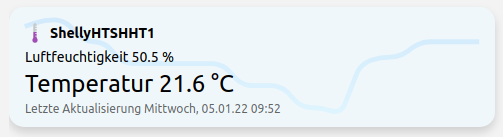

The Shelly H&T is a relatively inexpensive small sensor that provides temperature (_Temperatur) and humidity (_Luftfeuchtigkeit) via WLAN. However, it only reports when there is a change in its values, so it makes sense to also consider the time of the last update (_LetzteAktualisierung - the stateDescription Metadata is: %1$tA, %1$td.%1$tm.%1$ty %1$tH:%1$tM).

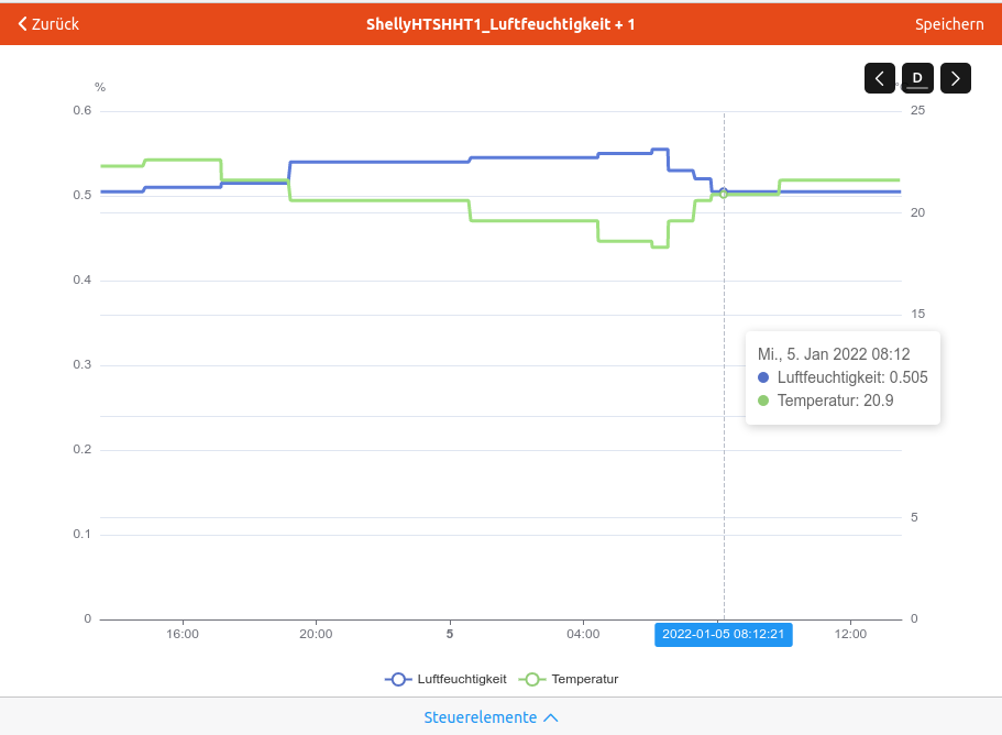

If you click on the card (see first screenshot), the following diagram will open

A few explanations about the code (even though no line numbers are shown here):
  • The first 15 lines mainly define the configuration settings. An item must be selected and a heading (ueberschrift) can be set.
  • With the lines 16 to 18 I actually want to achieve that only groups (so mainly equipment) can be selected. Unfortunately this does not work.
  • In line 23 it is specified that the entered ueberschrift is used as header, or if none was specified, the item name.
  • In line 24 the temperature output is generated, as main information. (I don’t understand why I can’t write “Temperature:” there, the colon is criticized).
  • Line 25 creates the blue temperature curve in the background
  • Line 26 and 27 configure the effect when clicking the card. Behind actionAnalyserItems an array is expected, see the square brackets. Therefore, multiple items are possible
  • The next lines are quite common, again I must not put a colon in my text.
  • With the lines 32 and 33 I achieve that at a humidity of more than 60% the background becomes red. To be able to compare the numbers, the unit (%) must be removed from the humidity, hence the split function.
