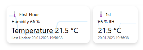

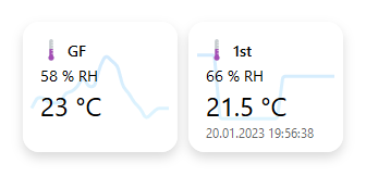

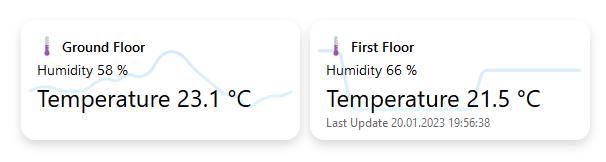

Screenshots
Example configuration with long labels:
Example configuration with short labels:

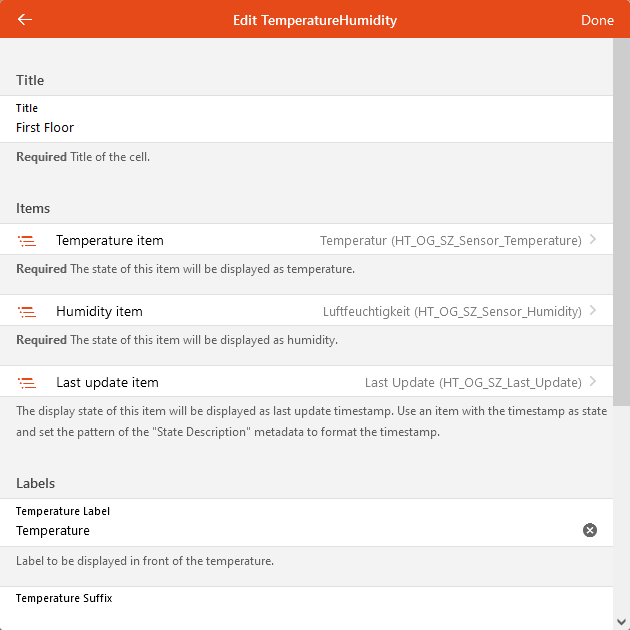

Configuration:

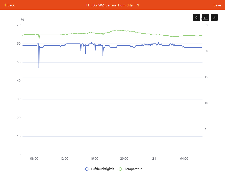

Clicking on the widget opens the analyzer displaying both the temperature and the humidity:
