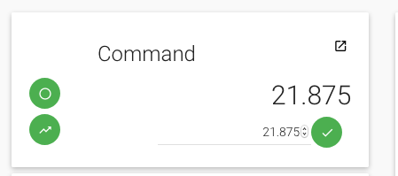

Try doing the comparison to 23.0 instead of 23.
Thanx for your reply. I changed but nothing happend.
try:
if ( (Temper.state as Number) > 23)
or
if ( (Temper.state as DecimalType) > 23)

It´s a String type.
Add .toString after state.
