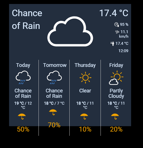

Here’s a pic of how it displays (without your suggestion in place). The Max/Min temperatures are towards the bottom of the columns, and both display the ‘°C’ (I want it removed from the first).
here’s my items:-
|Number:Temperature|W_F_0_Temp_Min|||"Today's Temp min [%.2f]"   |<temperature>|(gForecasts0)|||{channel="weatherunderground:weather:local:forecastToday#minTemperature"}|
|Number:Temperature|W_F_0_Temp_Max|||"Today's Temp max [%.2f]"   |<temperature>|(gForecasts0)|||{channel="weatherunderground:weather:local:forecastToday#maxTemperature"}|
here’s my panel code:-
<h5 style="margin-bottom:-10px;"><b>{{itemValue('W_F_0_Temp_Max')}}</b> / {{itemValue('W_F_0_Temp_Min')}}</h5>
Thanks in advance for any help you can give.

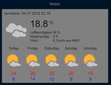

I´m new and i can’t html or jave but with the help in this thread i config a working habpanel view.
But now i have 3 questions cause i didn`t understand it.
First is the language problem. At which point i must copy the translate text in the example.hmtl ?
i have try at the beginnig but the Days like Monday didn’t translate.
Second is the third line under min and max temp in the forecast.
i try like this:
<!DOCTYPE html>
<html>
<head>
	<meta http-equiv="Content-type" CONTENT="text/html; charset=utf-8">
	<link rel="stylesheet" type="text/css" href="static/weather-data/layouts/example.css" />
	<script type="text/javascript" src="static/weather-data/layouts/example.js"></script>
</head>
<body id="weather-body" onload="formatIframe()">
	<div id="weather-location-name">${config:name}, ${weather:condition.observationTime(%1$td.%1$tm.%1$tY %1$tH:%1$tM)}</div>
	<table id="weather-table">
		<tr>
			<td rowspan="2"><img id="weather-icon" src="static/weather-data/images/${param:iconset}/${weather:condition.commonId}.png"/></td>
			<td id="weather-temp">${weather:temperature.current(%.1f)}</td>
			<td id="weather-temp-sign">°C</td>
		</tr>
		<tr>
			<td colspan="2">
				<table id="weather-table-details">
					<tr>
						<td>Luftfeuchtigkeit:</td>
						<td>${weather:atmosphere.humidity} %</td>
					</tr>
					<tr>
						<td>Niederschlag:</td>
						<td>${weather:precipitation.probability} %</td>
					</tr>
					<tr>
						<td>Wind:</td>
                    <td>${weather:wind.speed(%.1f)} km/h aus ${weather:wind.direction}</td>
                </tr>
				</table>
			</td>
		</tr>
	</table>
	<table id="weather-forecast-table">
		<tr>
			<td>Today</td>
			<td>${forecast(1):condition.observationTime(%1$tA)}</td>
			<td>${forecast(2):condition.observationTime(%1$tA)}</td>
			<td>${forecast(3):condition.observationTime(%1$tA)}</td>
	    	<td>${forecast(4):condition.observationTime(%1$tA)}</td>
		</tr>
		<tr>
			<td><img src="static/weather-data/images/${param:iconset}/${forecast(0):condition.commonId}.png"/></td>
			<td><img src="static/weather-data/images/${param:iconset}/${forecast(1):condition.commonId}.png"/></td>
			<td><img src="static/weather-data/images/${param:iconset}/${forecast(2):condition.commonId}.png"/></td>
			<td><img src="static/weather-data/images/${param:iconset}/${forecast(3):condition.commonId}.png"/></td>
			<td><img src="static/weather-data/images/${param:iconset}/${forecast(4):condition.commonId}.png"/></td>
		</tr>
		<tr>
			<td class="temp-max">${forecast(0):temperature.max(%.0f)}</td>
			<td class="temp-max">${forecast(1):temperature.max(%.0f)}</td>
			<td class="temp-max">${forecast(2):temperature.max(%.0f)}</td>
			<td class="temp-max">${forecast(3):temperature.max(%.0f)}</td>
			<td class="temp-max">${forecast(4):temperature.max(%.0f)}</td>
		</tr>
			<td class="temp-min">${forecast(0):temperature.min(%.0f)}</td>
			<td class="temp-min">${forecast(1):temperature.min(%.0f)}</td>
			<td class="temp-min">${forecast(2):temperature.min(%.0f)}</td>
			<td class="temp-min">${forecast(3):temperature.min(%.0f)}</td>
			<td class="temp-min">${forecast(4):temperature.min(%.0f)}</td>
		</tr>
		</tr>
			<td class="Precip_Probability">${precipitation(0):probability.min} %</td>
		</tr>
		<tr>
			<td class="Precip_Probability">${forecast(1):precipitation.probability} %</td>
		</tr>
	</table>
</body>
</html>
what is wrong ?
Last but not least is the formatting from the widget. when i change the example.css nothing saved.
how i can formatting the icons ??
thx for help
