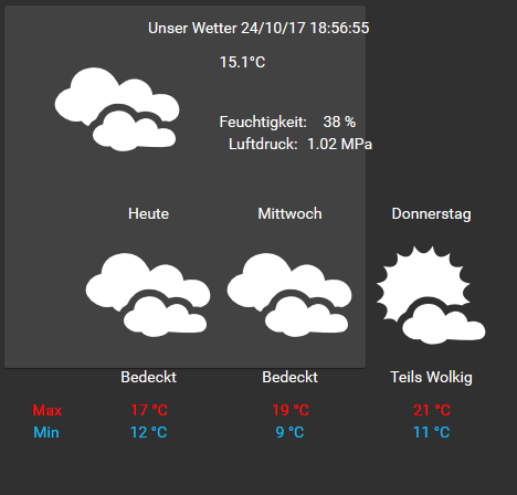

Hello Everybody,
i have a little problem with my weather widget.
The example.css has no effect on the look.
For example: When i make by #weather-icon the width or height smaller → Nothing

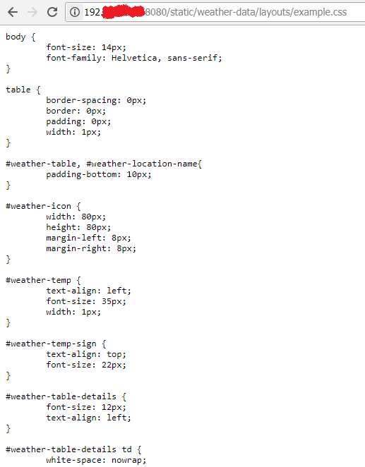

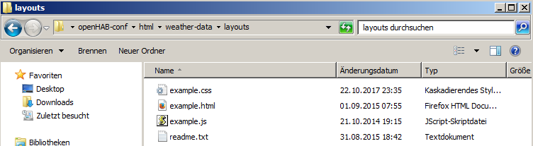

If you browse to
http://192...:8080/static/weather-data/layouts/example.css
does the css file load?
Yes, of course

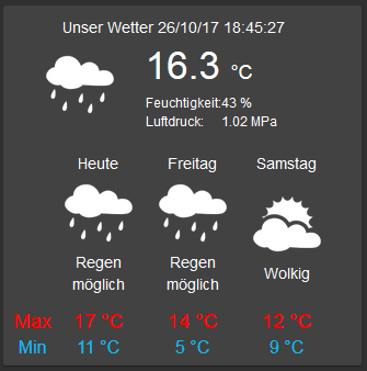

Hey AndyW,
love your widget, i’ve try to set German weekdays but don’t work.
Do you want to share your widget :), would be very nice.
Greetings,
Marcel
Please, where do I put the conditions?
sorry for my late reply… @Marcello87
I work for the german Weatherinformations with the WeatherUnderground Binding, while the Weather Binding doesn’t support the german translation and the mapping does not really work either.
But I need the Weather Binding for the pictures in the widget.
The german daynames is defined in the ng-init:
<div ng-init="ServerPath='../static'; IconSet='flat_white_wu'; daysnames={'Sunday': 'Sonntag', 'Monday': 'Montag', 'Tuesday': 'Dienstag', 'Wednesday': 'Mittwoch', 'Thursday': 'Donnerstag', 'Friday': 'Freitag', 'Saturday': 'Samstag'}">
</div>
And here it is called with the item:
<td ng-if="itemValue('ObservationTime1')!='UNDEF'">{{daysnames[(itemValue('ObservationTime1') | date:'EEEE')]}}</td>
For the pictures I take the “Condition_ID”, which means the same as the picture, so I don’t have to work with “lowercase, etc”.

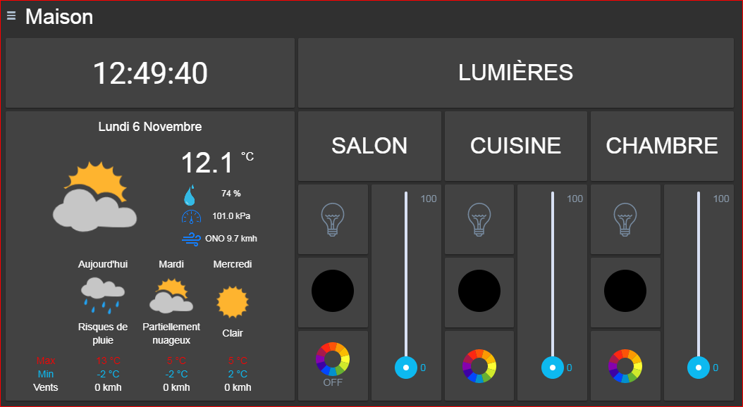

I finally figure it out! I install openHab on Simple mode instead of Expert mode. So for that, I could not seen the items when linking a channel. When I saw the items, it all went clear. Before that, I did not know at all where Condition0, Condition1, etc came from..
It’s all working well now!
Thank you!

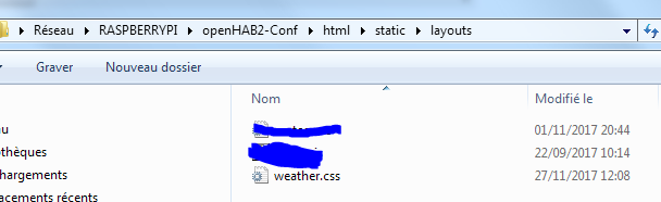

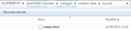

I run OH2.1 and try to install the weather binding.
I think I have a issue with the ServerPath because it’s impossible for me to acces to the css file stored in here :
Here the code posted by AndyMB I added :
<div ng-init="ServerPath='../static'; IconSet='flat_colorful'">
<link rel="stylesheet" type="text/css" href="{{ServerPath}}/layouts/weather.css" />
{{ServerPath}}
</div>
Even when I browse http://192…:8080/static//layouts/weather.css :frowning:
It look’s like the site configuration is pointing to another place so I tried to access to the webapps folder
Unfortunately…
What do you think about ?
Regards Vincent
Oups
even whith the right URL it doesn’t works
http://192…:8080/static/layouts/weather.css
http://192…:8080/static/ I’m not sure, but ‘static’ this in the address it is a folder ‘html’
try putting your files in the directory ‘/openHAB2-Conf/html/layouts/’
(http://192…:8080/static/ = /openHAB2-Conf/html/)
Indeed, http:// 192…:8080/static/ is linked to /openHAB2-Conf/html/.
So it was a mistake to create the static folder in /openHAB2-Conf/html/static.
As it was written, OH was attented to find the weather.css file in the http:// 192…:8080/static/static/layouts folder.
Thank you four your help Olymp !
