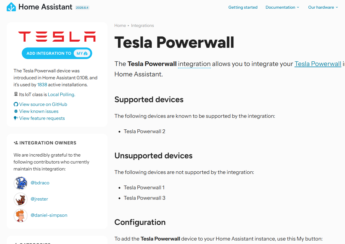

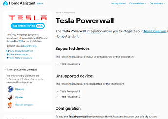

Not sure if I understand the logic behind using HA to integrate the Powerwall3 for OpenHAB, unless I am missing a key piece of info (i.e. an alternative to the options below):
  • HA Tesla Powerwall integration explicitly excludes support for the Powerwall 3:
  • HA Tesla Fleet Integration, as you mention, relies on Cloud integration for Powerwall3 read & write values, and whilst it covers the essentials, it also misses a lot of the information available locally for the Powerwall 3 (e.g. individual MPPT input stats)
  • HA powerwall3mqtt integration was abandoned in deference to using the cloud integration
Using pypowerwall-proxy or the upcoming pypowerwall-server allows local read of stats from the Powerwall3, including the extended data not available via the Fleet API. It also supports fleet API for control. It also looks like the author of this project intended it to be used for HA integration (via MQTT), but that still requires firing up a container with pypowerwall-server.
My use case may be different to some, in that I want local integration where possible, and also extended information about the individual MTTP inputs (among other things), but unless there is an option I have missed above, I am struggling to see a benefit to integrate PW3 via HA, vs leveraging the pypowerwall-proxy or server.
