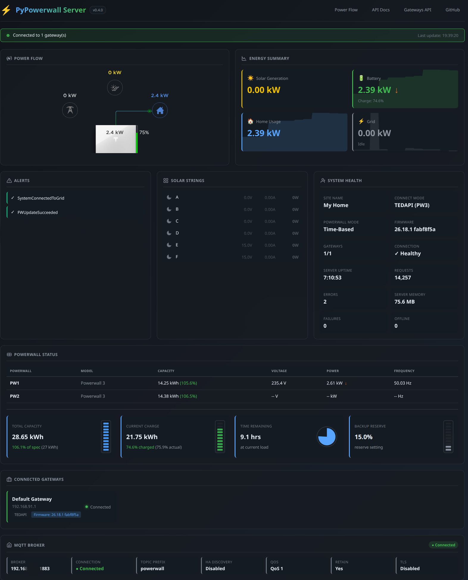

Browse to your Openhab server (assuming you are running the Docker container on there), on port 8675 (http://openhabserveraddress:8675/ ), and you should then see a page similar to the following:
If the powerwall is showing as copnnected, and also the MQTT connection (bottom of the screen) this means you should be ready to move onto the next step, of setting up OpenHAB itself.
