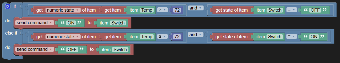

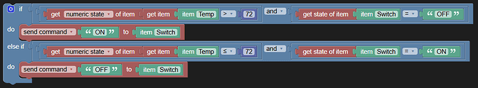

  1. Code it yourself. Trigger a rule when the temperature changes. You’ve already ladies out the logic in your bullet points. Using Blockly create and if block and add else if blocks to it (click the cog icon and drag and drop) until you have four. Add a condition to each just as you outline above and send the command that’s appropriate. Again, I recommend hysteresis so use something lower than 75 to turn off.
I guess I just don’t understand blockly to get through this one. Never used it before so it’s just not making sense to me.
