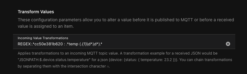

  1. Create the MQTT thing to connect to the broker. Do not configure channels on it.
  2. Create a new ‘thing’ for each device (Just one?)
  3. For each sensor on the ‘device’ thing you created, configure a channel.
  4. In the channel configure the MQTT State Topic (‘tele/SerreScanner/SENSOR’ in your case) and under the advanced section add an input transform as a REGEX. e.g.
Note that OH REGEX’s are ‘unique’ in that you have to match the WHOLE input line (i.e. prefix and postfix with .*). You an see from the transport I use that it matches a MAC address… Which is the identifier for each sensor I have on my 1 mqtt topic. (I actually have two REGEX’s for each sensor. Temp and Humid so you can pull multiple data from each entry just by configuring a separate channel) - I did wonder if you can pull two items per channel, but haven’t investigated how I’d do that yet and 2x channels works anyway.
  1. Add an item to the channel. Make sure you select ‘default’ for the items profile or the item won’t get the read value set.
Channel will then look like this
Check the event logs to make sure it’s updating…I found OH’s REGEX’s a PITA to debug TBH so don’t try to change too much at once. Get one thing working and go from there.
