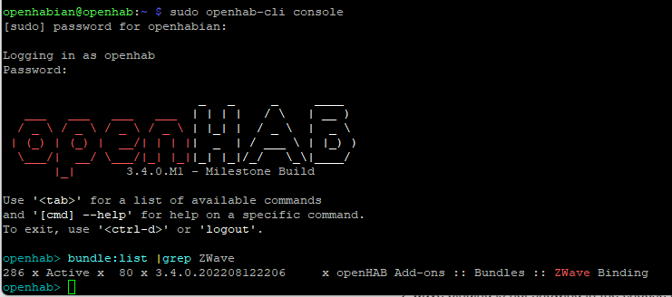

Do you see the binding using openhab-cli console?
yup :slight_smile:
openhab> bundle:list |grep ZWave
274 │ Active │ 80 │ 3.4.0.202209010348 │ openHAB Add-ons :: Bundles :: ZWave Binding
openhab>
binding perfectly loaded up and running…
