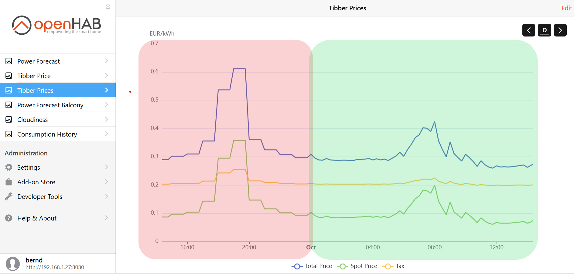

Nice to see Marketplace binding can handle price updates: red = hourly prices, green = 15 minutes prices.
