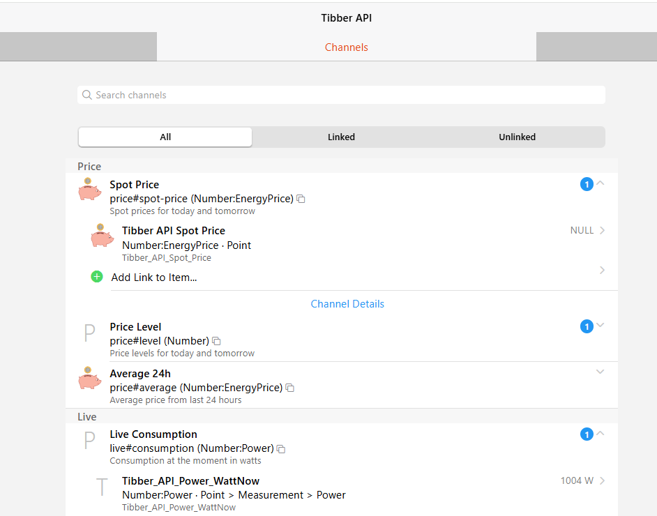

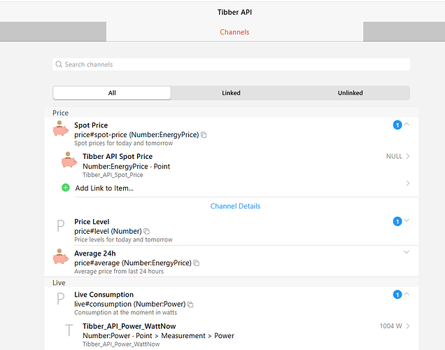

I experience same problem as others. Since I upgraded OH4>5 I have issues with Tibber and my heater is again “dummy”, so:
  • Live data items works correctly - like energy consumption and volts taken from Tibber Pulse
  • Spot price and Price level items are always NULL

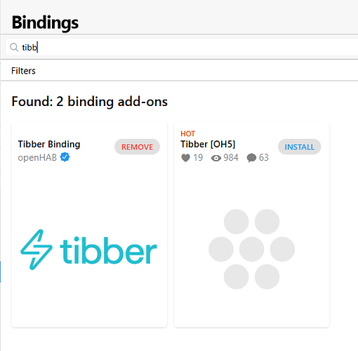

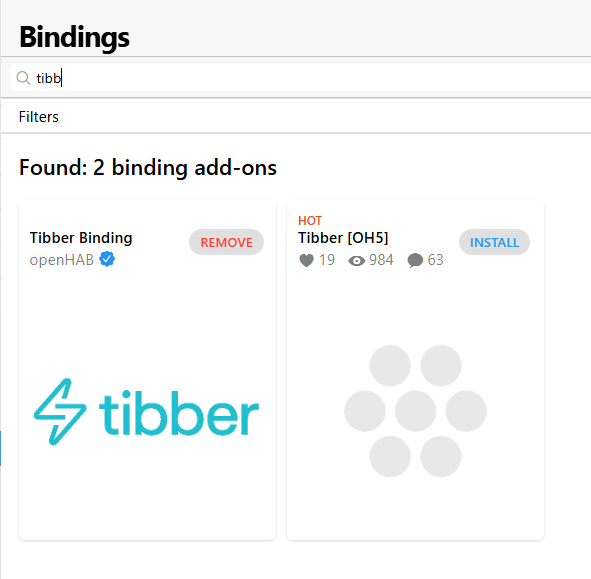

What I tried to do - upgrade from OH 5.1 stable to snapshot version, reinstalling the Tibber binding, trying Tibber marketplace version as well - nothing helped, same behavior.
Right now I stayed on OH 5.1.0-SNAPSHOT - Build #4788 and have official Tibber binding as per picture:

While reading this thread I found this advice:
Please double check if all items from price group are connected to a forecast persistence strategy. Similar to solarforecast binding these are future values showing the day-ahead info with price, level and average24h values.
But I don’t have any persistance enabled in my OH. In fact I don’t need it as I initialize all important item values in my startup rule of OH and it works perfect. And I do not want to increase load on CPU and disk for storing persistance data´in DB. So I simply do not need it.
But is it maybe requirement for Tibber since OH5 to have the persistance Add-On? Could you please confirm that?
I have not try activating rrd4j add-on yet, but still would like to avoid it.
My heater became dummy since OH5 update since I do not manage it by the Tibber price levels anymore for quite a long time. However recently I managed to find an “ugly workaround” - I have written the python html-parsing script that takes data from the table on the HTML page https://elspot.nu/dagens-spotpris/timpriser-pa-elborsen-for-elomrade-se3-stockholm/ and then convert those into text file, which is then parsed by OH rule every hour. That works but is defenitely not optimal and a lot of code is involved…
In fact I don’t have experience without any persistence installed in an OH system. Especially if you mention “I initialize all important item values in my startup rule of OH and it works perfect” looks like you’re doing some kind of refresh, otherwise the value from the previous lifecycle cannot be obtained without being stored before.
But I think I understand your point so let’s dig into it:
I would say yes, you need a persistence addon, see below.
Correct, don’t do it as rrd4j doesn’t support future values. It will not help!
I don’t know the complete history when forecast TimeSeries were introduced but I know the core developers were aware that not everbody has a database service installed likeinfluxdb, mysql,… . So inmemory persistence was introduced - no database, no storage on disc just temporary RAM. I think this shall fufill your requirements
I would ask you to give it a try

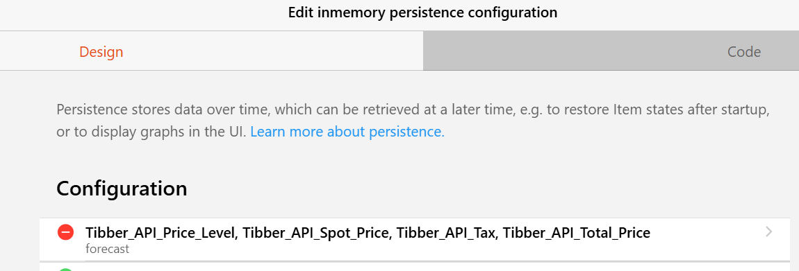

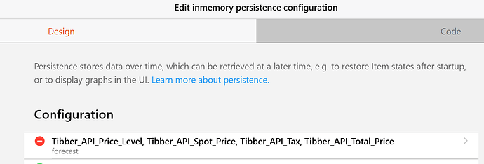

  • Install inmemory persistence addon
  • Add price items to configuration (example picture below) and save configuration
  • Shortly disable Tibber thing and enable again to refresh values
  • FYI - after startup Tibber binding refreshes prices automtically so there’s no restore values necessary
Thousand thanks @weymann for a very prompt response, much appreciated!
I now tried your recommendations and now all works as a charm! :+1:
InMemory persistance configuration is:
And after disabling / enabling the thing, the result became:

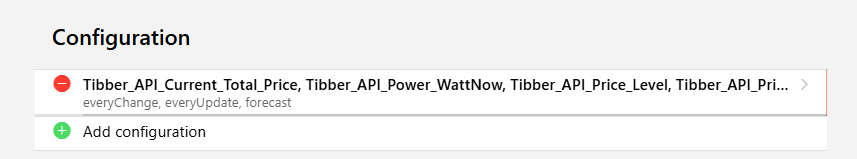

Did you create a persistence rule with forecast for the items?
Only after I did that did the items in the price group stop being NULL.
What do you mean with a persistance rule? The Items are assigned to groups and I have persistance configured on this groups.
For my forecast solar I needed a forecast strategy to be defined in order to get the forecast data. But for tibber I did not have that.
So what kind of rule are you talking about? And where is that mentioned in the docs?
I mean under Settings → Add-on Settings → the relevant Persistence → persistence configuration
It states multiple times, that you need a persistence for forecasted items, and not rrd4j.
the spot-price and level channel (and total-price for >=5.1/marketplace binding) need forecast to function properly.
I have file based config. And yes, the “Energy*” groups are persisted every 2 minutes. I have now added a forecast group with strategy “forecast”. And added the items only to that group.
In the log I got the info, that data has been received. And when I analyze the Item, I see forecast values now. But the Item itself remains NULL.
EDIT: After some waiting/ reloading the items are now also showing values!

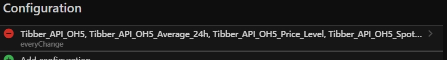

Iam using the last snaphot: org.openhab.binding.tibber-4.3.8-SNAPSHOT-Hourly.jar but there no price updates in any item.
Here´s the event.log:
2025-09-26 13:24:38.999 [INFO ] [hab.event.ItemTimeSeriesUpdatedEvent] - Item ‘Tibber_API_OH5_Total_Price’ updated timeseries with 48 values.
2025-09-26 13:24:39.001 [INFO ] [ab.event.ThingStatusInfoChangedEvent] - Thing ‘mail:smtp:ad7c2719ad’ changed from UNINITIALIZED (NOT_YET_READY) to INITIALIZING
2025-09-26 13:24:39.034 [INFO ] [hab.event.ItemTimeSeriesUpdatedEvent] - Item ‘Tibber_API_OH5_Spot_Price’ updated timeseries with 48 values.
2025-09-26 13:24:39.035 [INFO ] [ab.event.ThingStatusInfoChangedEvent] - Thing ‘mail:smtp:ad7c2719ad’ changed from INITIALIZING to ONLINE
2025-09-26 13:24:39.062 [INFO ] [hab.event.ItemTimeSeriesUpdatedEvent] - Item ‘Tibber_API_OH5_Tax’ updated timeseries with 48 values.
2025-09-26 13:24:39.076 [INFO ] [hab.event.ItemTimeSeriesUpdatedEvent] - Item ‘Tibber_API_OH5_Price_Level’ updated timeseries with 48 values.
Did you setup InMemory persistence for the TimeSeries items ? That’s a prerequisite.
Yes, inMemory is active and configured, items always null.
